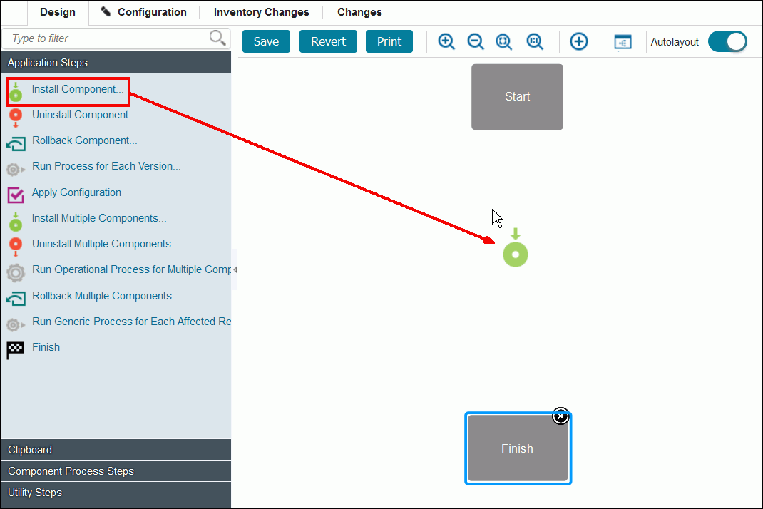

When the Process Design pane opens, the Design view is displayed. Processes are assembled with the Design view. Available steps are listed at the left of the window. HCL Launch provides several utility steps and plug-ins. More plug-ins and documentation for those plug-ins are available on: HCL Plug-ins website.

To add a step:
The step is in the design space and is connected to other steps. If you change your mind, click Cancel to remove the step from the design space.

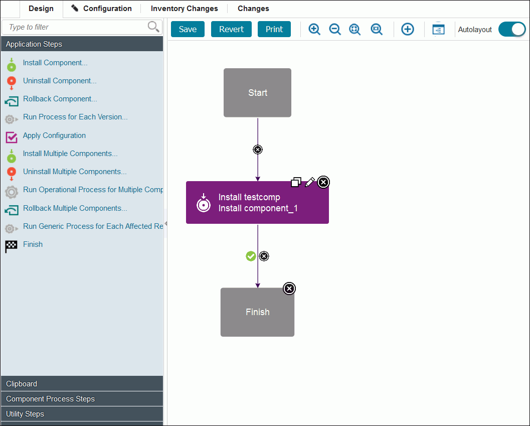

Verify that the step connections create the required process flow:
Connections control the process flow. The originating step runs before the target step. If you move steps or do not highlight a connection link when you place a step, creating a connection between steps is a simple process. You drag a connection from the originating step to the target step. Connections are typically formed automatically. However when you create them manually, connections are formed one at a time between two steps, the originating step and the target step. To create connections manually:
Each connection has a connection delete tool, conditional flag, and might have other tools depending on the originating step. Remove a connection by clicking the delete tool.

Verify that the flow of steps is correct.
Each process starts with the Start step and continues until it reaches the Finish step. Therefore, the Start step must connect to the first step or steps to run. Similarly, the last steps must connect to the Finish step, or else the process does not finish correctly.

To open the
. When you drag the first property on the design pane, you can place the step anywhere on
the design space. Connection links are automatically created from the Start node to the step and
from the step to the Finish node. When you add more steps, drag them and position them so that they
highlight the connection link between stesps so that the step is inserted and connection links are
automatically created between the steps. Steps can be dragged and positioned at any time. However,

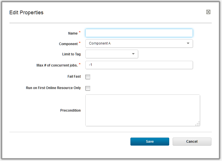

Configuration dialogs boxes are tailored to the selected step. Only parameters that are
associated with the step type are displayed.
