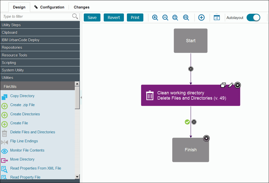

The process opens in the process editor. This editor shows the steps in the process in a graphical form, as a flowchart. The Start and Finish boxes represent the beginning and the end of the process. From here, you add steps to the process and link them between the Start and Finish steps to show the order of the steps.
Add a step to clean any files out of the working directory.
The process runs within a working directory. To ensure that you are using the most recent version of the files in the web component, run a command to clean the working directory:The new step is displayed as a box in the process editor. The process editor looks like the following figure:

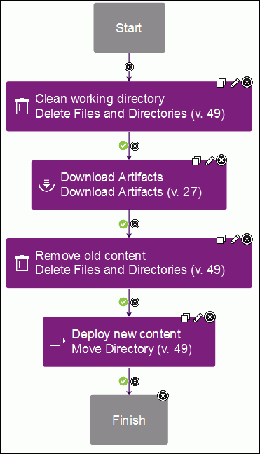

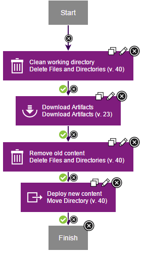

Add a step to remove the old web content from the server:
Add a step to deploy the new content to the server.
This step copies the component artifacts to the application server.Now the process has four steps, as in the following figure:
deletes the step. The Copy icon
- Optional:
If your steps are not connected or are not connected in the correct order, you can connect the
steps manually:
You can connect steps in a sequence like these steps, or you can run steps in parallel with each other by creating more links. However, processes always start with the Start step and end with the Finish step. The sequence of steps in this process is as follows:
StartClean working directoryDownload ArtifactsRemove old contentDeploy new contentFinish
- Save the process by clicking Save.

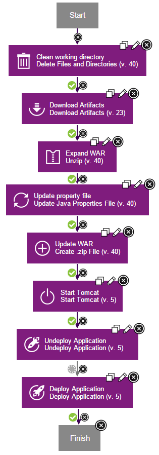

Creating a component process for the application component
The application component consists of a single WAR file. This component process downloads the most recent version of the WAR file, updates values in the file, and deploys the file on the application server.
- From the Components tab, click the JPetStore-APP component.
- Click Processes, and then click Create Process.
- In the Create Process window, specify the name as Deploy application component.
- In the Process Type list, select Deployment.
- Accept the default values for the other properties, and click Save.
In the process editor, add a step to clean the working directory.
As you did for the web component, add a Delete Files and Directories step named Clean working directory, and specify a period in the Base Directory field and
**/*in the Include field. -
Add a step to download the artifacts.
Download Artifactsstep, and accept the default properties. -
Add a step to extract the WAR file.
You must extract the WAR file so you can update a property file with the database connection information.
Add a step to update the property file with the location of the database:
Add a step to update the WAR file with the new property file:
Add a step to start Tomcat:
Add a step to remove any previous versions of the application:
Add a step to deploy the updated WAR file to the application server:
- Optional:
If required, arrange and connect the steps in the following order:
StartClean working directoryDownload ArtifactsExpand WARUpdate Property FileUpdate WARStart TomcatUndeploy ApplicationDeploy ApplicationFinish
Change the conditional flag on the link between the
Undeploy ApplicationandDeploy Applicationsteps tobothby clicking the green check mark on the connection until it turns to a gray circle, as shown in the following figure:
Each connection from one step to another has a conditional flag. The conditional flag specifies a condition for the connection. Three conditional flags are available:- By default, the conditional flag on each connection is set to
success, which is represented by a green check mark. The process follows these connections when the step succeeds. - The conditional flag
failis represented by an exclamation point (!) in a red field. The process follows these connections when steps fail. - The conditional flag
bothis represented by a gray circle. The process follows these connections regardless of whether a step succeeds or fails.
Undeploy Applicationstep fails if no previous versions of the application are installed. In this case, setting the conditional flag on the connection tobothspecifies that the process keeps running regardless of whether the step fails or succeeds. - By default, the conditional flag on each connection is set to
- Save the process.

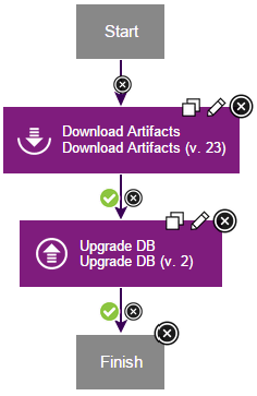

Creating a component process for the database component
The deployment process for the database component updates the database with sample values.
JPetStore-DBcomponent. - Click Processes, and then click Create Process.
- In the Create Process window, specify the name as Deploy database component.
In the process editor, add a step to download the artifacts.
Add a step to update the database:
You must create a database version table on every target database either manually before you run the DBUpgrader plug-in steps for the first time or as part of the first change.
- Optional:
StartDownload ArtifactsUpgrade DBFinish
- Save the process.
In this lesson, you created component processes to deploy the components.
