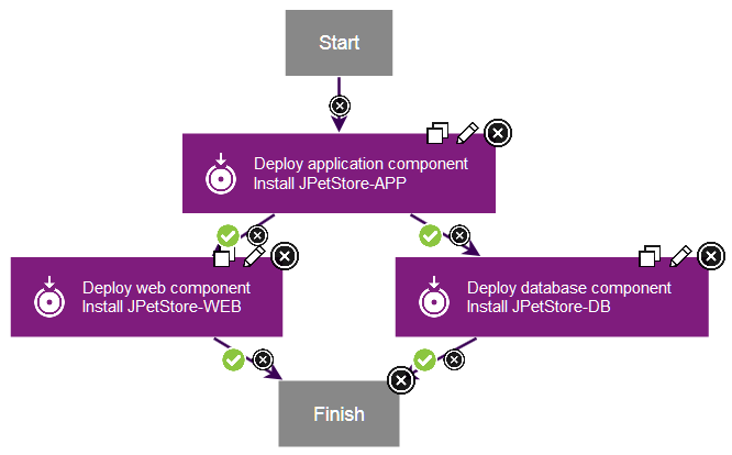

- Add a step to deploy the application component:
- Similarly, add a step that is named Deploy web component to deploy the web component.
- Similarly, add a step that is named Deploy database component to deploy the database component.
Verify that the
Startstep is connected to theDeploy application componentstep. - Instead of connecting the remaining steps in a straight
line, follow these steps to connect the steps so that they run at
the same time.Use the figure at the end of this step as a reference point.
- Save the process.
