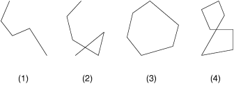

An ST_LineString is simple if it does not intersect its interior. The endpoints (the boundary) of a closed ST_LineString occupy the same point in space. An ST_LineString is a ring if it is both closed and simple. In addition to properties inherited from the superclass ST_Geometry, ST_LineString values have length.
The endpoints normally form the boundary of a ST_LineString unless the ST_LineString is closed, in which case the boundary is NULL. The interior of a ST_LineString is the connected path that lies between the endpoints, unless it is closed, in which case the interior is continuous. The following figure shows examples of ST_LineString objects: (1) is a simple nonclosed ST_LineString; (2) is a nonsimple nonclosed ST_LineString; (3) is a closed simple ST_LineString and therefore is a ring; (4) is a closed nonsimple ST_LineString—it is not a ring.
Figure 1. Examples of ST_LineString objects
(1) is a line string that does not intersect itself. (2) is a line string that intersects itself at one point. (3) is a polygon. (4) is a line string that creates two polygons that are connects at one point.
