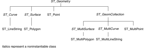

The ST_Geometry data type is an abstract noninstantiable superclass. Its subclasses provide instantiable data types. As such, you can define table columns to be of such types. The following figure shows the class hierarchy for the HCL® Informix® spatial data types.
Figure 1. Data types class diagram
The ST_Geometry type has four subclasses: ST_Curve, with a subclass of ST_LineString; ST_Surface, with a subclass of ST_Polygon; ST_Point; ST_GeomCollection with three subclasses. The subclasses of ST_GeomCollection are: ST_MultiSurface, with a subclass of ST_MultiPolygon; ST_MultiCurve, with a subclass of ST_MultiLineString; and ST_MultiPoint. Only classes without subclasses are instantiable.
Throughout the remainder of this publication, the terms geometry or geometries collectively refer to the superclass ST_Geometry data type and all of its subclass data types. When it is necessary to specify the geometry superclass directly, it is referred to as the ST_Geometry superclass or the ST_Geometry data type.
Tip: You can define a column as type ST_Geometry, but ST_Geometry values cannot be inserted into it since they cannot be instantiated. However, any of the ST_Geometry subclass data type values can be inserted into this column.
