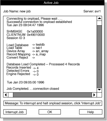

Active Job window
The Active Job window reports the progress of your job. The following figure shows the Active Job window after the load is complete.
Figure 1. The Active Job window
When the Active Job window reports that the load job is complete, click OK to return to the Load Job Select window.
