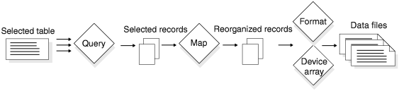

The following figure shows how the components of the affect the data as it moves from a database to data files during the unload process. The HPL uses:
  • The query to select records from the database
  • The map to reorganize or modify the selected records
  • The format to prepare the records for writing out to the data files
  • The device array to find the location of the data files
Figure 1. The data-unload process
