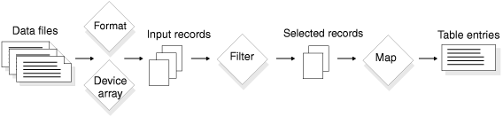

When you prepare to run a data load with the HPL, you describe the actions that the HPL must take by defining a set of metadata components. The components describe different aspects of the load process. The HPL uses information from:
  • The device array to find the set of the source-data files
  • The format to define the data types and layout of the source data
  • The filter to select the records from the source data that should be written to the database table
  • The map to modify and reorganize the data
The ipload utility helps you prepare the components. Load data to a database table, addresses the process of loading a file to a database.
The following figure shows the data load process. The figure summarizes the data-load process by showing how data moves from data files to table entries.
Figure 1. The data-load process
