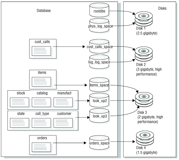

Sample layout when performance is highest priority
- Migration of the logical log and physical log files from the root dbspace This strategy separates the logical log and the physical log and reduces contention for the root dbspace. For best performance, take advantage of automatic performance tuning for the logical and physical logs:
- Create a plogspace to enable the automatic expansion of the physical log.
- Set the AUTO_LLOG configuration parameter to enable the automatic expansion of the logical log in a specified dbspace.
- Location of the two tables that undergo the highest use in dbspaces on separate disks
Neither of these disks stores the logical log or the physical log. Ideally you might store each of the items and orders tables on a separate high-performance disk. However, in the present scenario, this strategy is not possible because one of the high-performance disks is required to store the large cust_calls table (the other two disks are too small for this task).

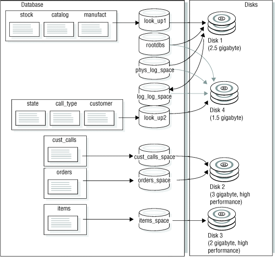

Sample layout when availability is highest priority
The weakness of the previous disk layout is that if either Disk 1 or Disk 2 fails, the whole database server goes down until you restore the dbspaces on these disks from backups. In other words, the disk layout is poor with respect to availability.
