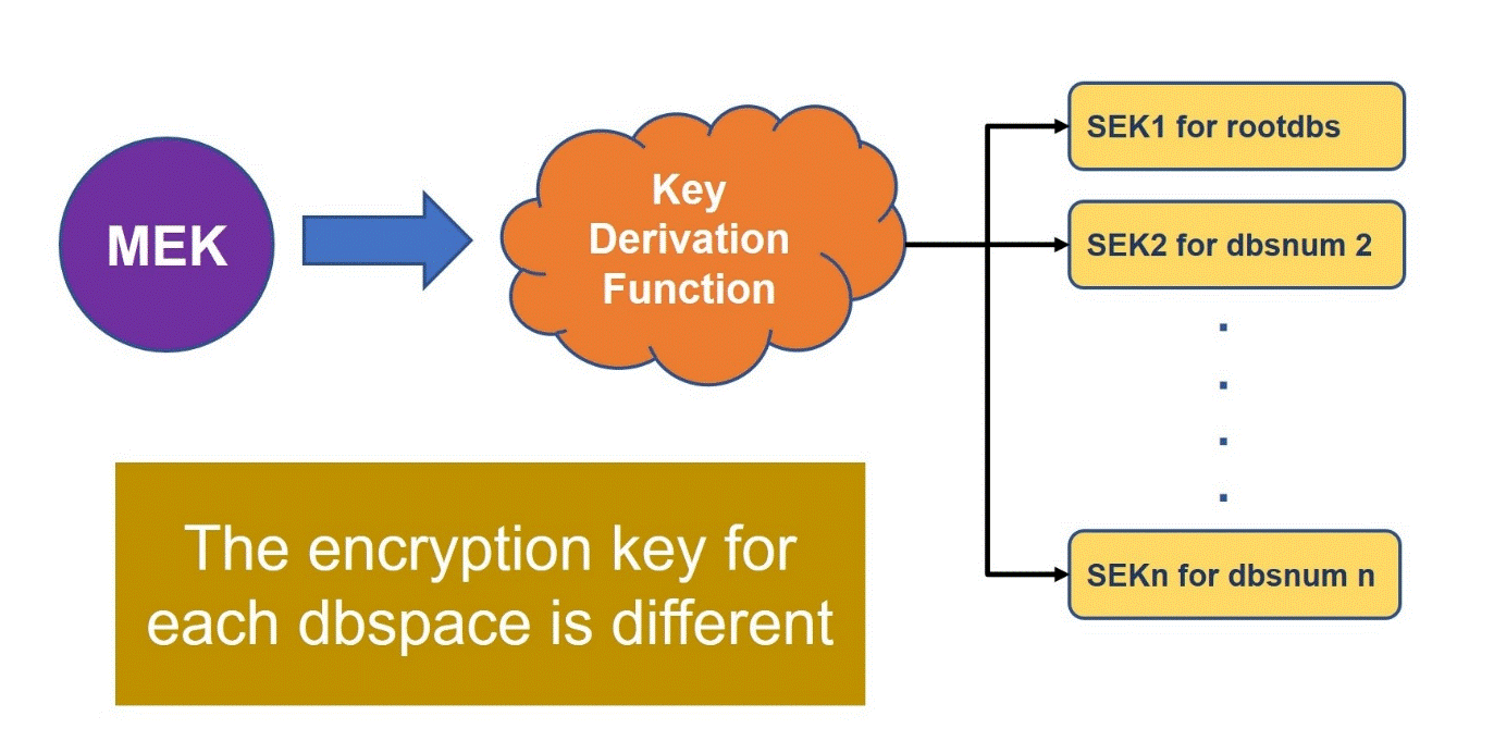

Each storage space is encrypted separately with its own encryption key. By default, the encryption cipher is set to AES with 128-bit keys. You can specify a stronger encryption key by including the cipher option in the DISK_ENCRYPTION configuration parameter value.
Any storage space that you create when storage space encryption is enabled is automatically encrypted, unless you explicitly specify to create it as unencrypted with the onspaces utility. If you initialize a new database server before setting the DISK_ENCRYPTION configuration parameter, the root dbspace and all storage spaces created before setting DISK_ENCRYPTION are not encrypted. However, you can encrypt unencrypted storage spaces, including the root dbspace, by running a restore that encrypts the spaces.
As mentioned above, each storage space is encrypted with its own Space Encryption Key (SEK). The SEKs are generated by the system (oninit) based on a Master Encryption Key (MEK). The MEK is created by the onkstore utility and can be stored locally in the keystore created by the onkstore, or remotely in a Remote Key Server (RKS). In both cases, you must use the onkstore utility to create a keystore that will contain a MEK or the credentials necessary to reach the MEK at a Remote Key Server.

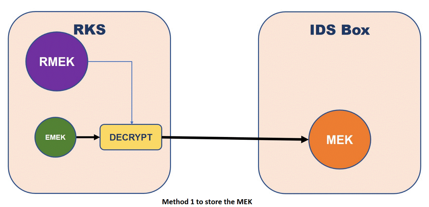

- Option 1: The MEK is stored at the RKS encrypted using a a Remote Master Encryption Key.
The Remote Master Encryption Key (RMEK) is a managed key (managed by the RKS) and never leaves the
RKS. Currently, we will use this method with AWS-KMS and Azure KeyVault RKS. In the case of AWS, the
MEK is generated remotely at the AWS infrastructure. In the case of Azure, the MEK is generated
locally. In bothe cases the MEK will the be encrypted with RMEK and the result stored at the Cloud
server.
Figure 2. Method 1 to manage the MEK

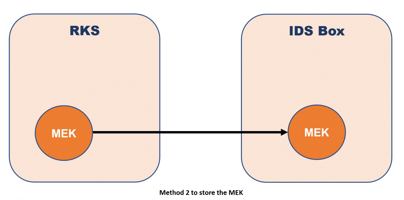

- Option 2: The MEK is the Managed Key (Managed by the RKS), its encrypted and protected
internally by the RKS. Currently, this method is used with KMIP RKS.
Figure 3. Method 2 to manage the MEK
