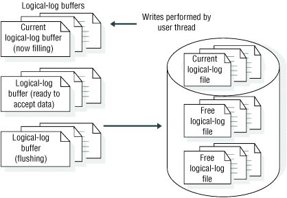

The database server uses only one of the logical-log buffers at a time. This buffer is the current logical-log buffer. Before the database server flushes the current logical-log buffer to disk, it makes the second logical-log buffer the current one so that it can continue writing while the first buffer is flushed. If the second logical-log buffer fills before the first one finishes flushing, the third logical-log buffer becomes the current one. This process is illustrated in the following figure.
Figure 1. The logical-log buffer and its relation to the logical-log files on disk
The paragraph that precedes this figure describes the content of the figure.
For a description of how the database server flushes the logical-log buffer, see Flush the logical-log buffer.
