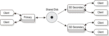

The following figure shows an example of a primary server with two SD secondary servers. In this case the role of the primary server can be transferred to either of the two SD secondary servers. This is true whether the primary must be taken out of service because of a planned outage, or because of failure of the primary server.
Figure 1. Primary server configured with two SD secondary servers
The paragraph that precedes this figure describes the content of the figure.

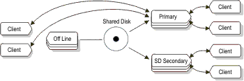

Because both of the SD secondary servers are reading from the same disk subsystem, they are both equally able to assume the primary server role. The following figure illustrates a situation in which the primary server is offline.
Figure 2. SD secondary server assuming role of primary server
The illustration shows the primary server offline, with clients being redirected to the SD secondary server, which assumes the role of the primary.

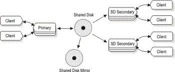

There are several ways to protect against hardware failure of the shared disk. Probably the most common way is to configure the disk array based on RAID technology (such as RAID-5). Another way to protect against disk failure is to use SAN (Storage Area Technology) to include some form of remote disk mirroring. Since SAN disks can be located a short distance from the primary disk and its mirror, this provides a high degree of availability for both the planned and unplanned outage of either the server or of the disk subsystem. The following illustration depicts such a configuration:
Figure 3. Primary server and SD secondary servers with mirrored disks

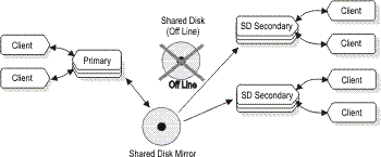

In the event of a disk failure, the servers can be reconfigured as in the following illustration:
Figure 4. Shared disk mirror after failure of primary shared disk
This figure illustrates one of the shared disk arrays offline due to a hardware failure while the shared disk mirror takes over.

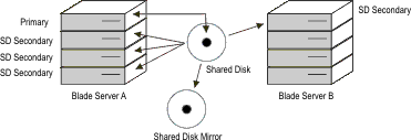

In addition to configuring a mirrored disk subsystem as in the previous illustration, you might want to configure additional servers. For example, you might want to use the primary and two SD secondary servers within a single blade server enclosure. By placing the server group within a single blade server, the blade server itself can become a failure point. The configuration in the following illustration is an attractive solution when you must periodically increase read processing ability such as when performing large reporting tasks.
Figure 5. Primary and SD secondary servers in a blade server
You might decide to avoid the possible failure point of a single blade server by using multiple blade servers, as in the following illustration.
Figure 6. Multiple blade server configuration to prevent single point of failure
This figure illustrates a blade server consisting of a primary server and multiple SD secondary servers, with a second blade server sharing a mirrored disk array.

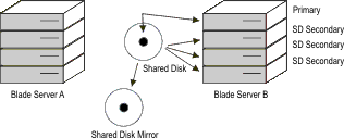

In the previous illustration, if Blade Server A fails, it would be possible to transfer the primary server role to the SD secondary server on Blade Server B. Since it is possible to bring additional SD secondary servers online very quickly, it would be possible to dynamically add additional SD secondary servers to Blade Server B as in the following illustration.
Figure 7. Failover after failure of blade server

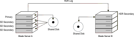

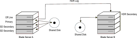

Because of limits on the distance between the primary and mirrored disks that disk mirroring can support, you might be concerned about using shared disks and relying on shared disk mirroring to provide disk availability. For example, you might want significant distance between the two copies of the disk subsystem. In this case, you might choose to use either an HDR secondary or an RS secondary server to maintain the secondary copy of the disk subsystem. If the network connection is fairly fast (that is, if a ping to the secondary server is less than 50 milliseconds) you must consider using an HDR secondary server. For slower network connections, consider using an RS secondary server. The following illustration shows an example of an HDR secondary server in a blade server configuration.
Figure 8. HDR secondary server in blade server configuration
In the configuration shown in the previous illustration, if the primary node fails, but the shared disks are intact and the blade server is still functional, it is possible to transfer the primary server role from the first server in Blade Server A to another server in the same blade server. Changing the primary server would cause the source of the remote HDR secondary server to automatically reroute to the new primary server, as illustrated in the following diagram:

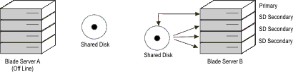

Suppose, however, that the failure described in the previous illustration was not a blade within the blade server, but the entire blade server. In this case you might be required to fail over to the HDR secondary. Since starting an SD secondary server is very quick, you can easily add additional SD secondary servers. Note that the SD secondary server can only work with the primary node; when the primary has been transferred to Blade Server B, then it becomes possible to start SD secondary servers on Blade Server B as well, as shown in the following illustration.
Figure 10. Failure of entire blade server
