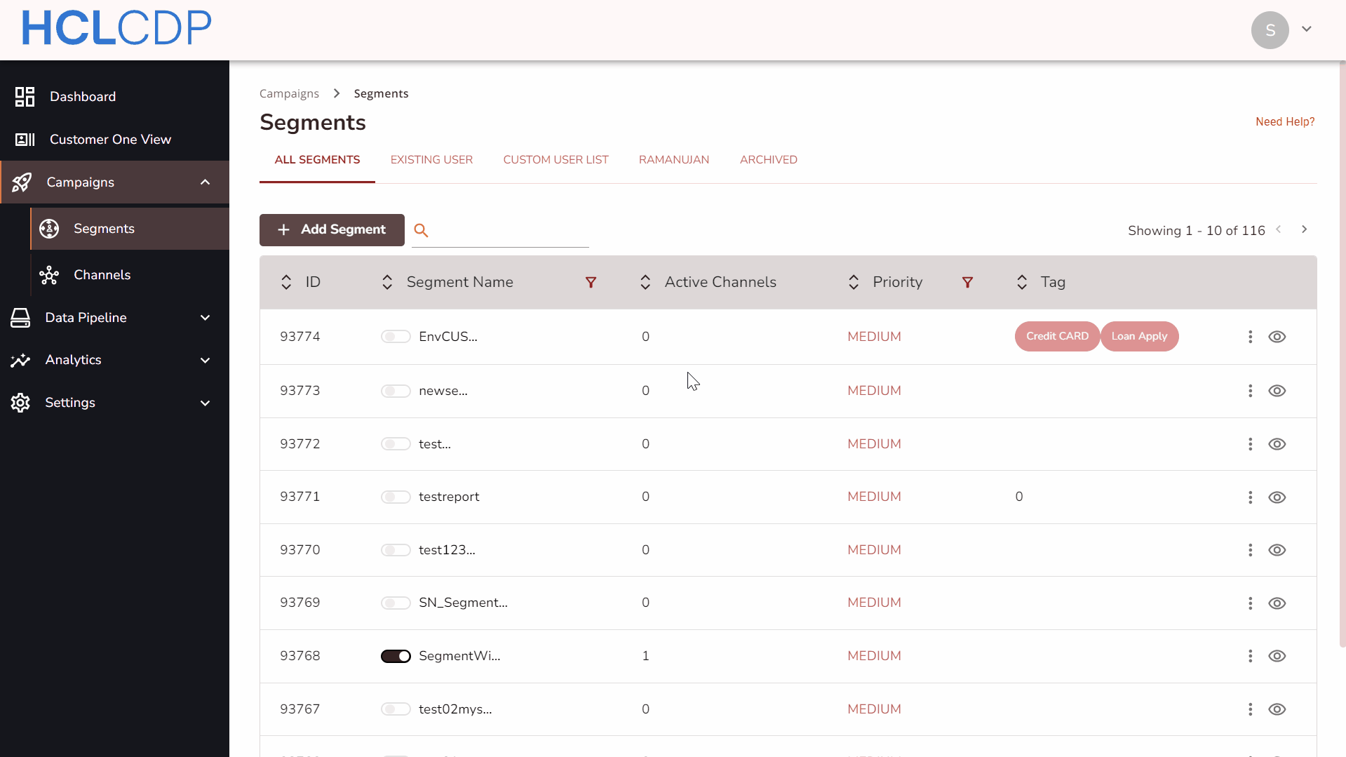

To create an App push notification engagements from segments, follow the steps below:
- Navigate to .
- Select the Segment Name, and on the left panel, click the App Push Notification option.
- Click Add Engagement.

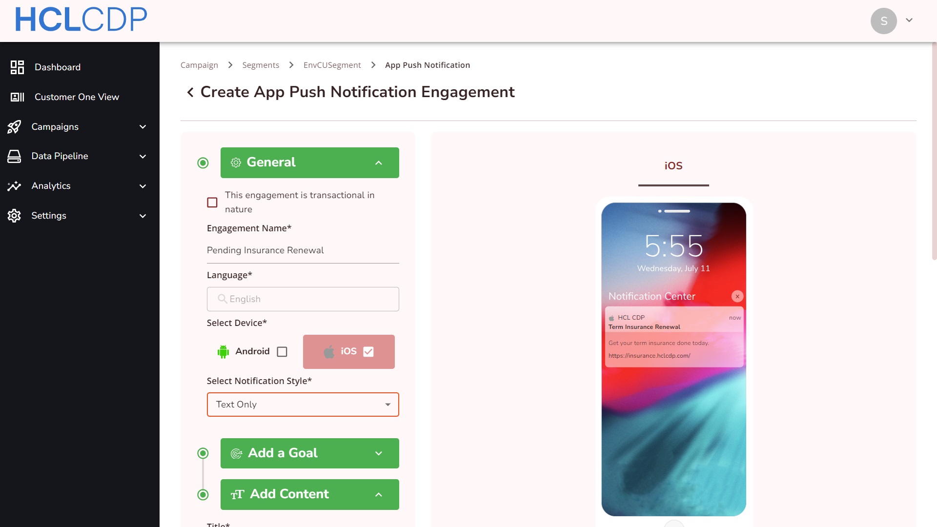

In the create app push notification page, configure the following details:
Add General Details
- Engagement Name (mandatory): Add a unique name to the Engagement. It must range between 6-25 characters.
- Language (mandatory): Select a language in which you prefer to write the Engagement.
- Select Device (mandatory): Select iOS from the device list. The preview on the right should show the preview of the iOS device.
- Select Notification Style (mandatory): Choose a notification style of engagement based on device configuration.
For iOS, we have two Notification Styles.
- Text Only: Use this notification style, in case you want to add only
text to your App Push engagement.
- Text with Rich Media: You can include images, audio, or video in your
notifications. Make your engagement more engaging and easy to understand by
adding media to your text. Tip: Each section turns red as you start entering data to create an Engagement. Once you fill in all the required information, the section will turn green. You can complete the sections in any order, but all sections must be green before you can click Update Engagement.

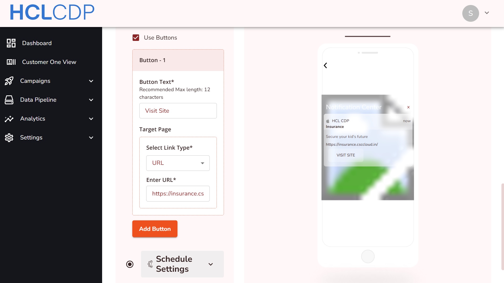

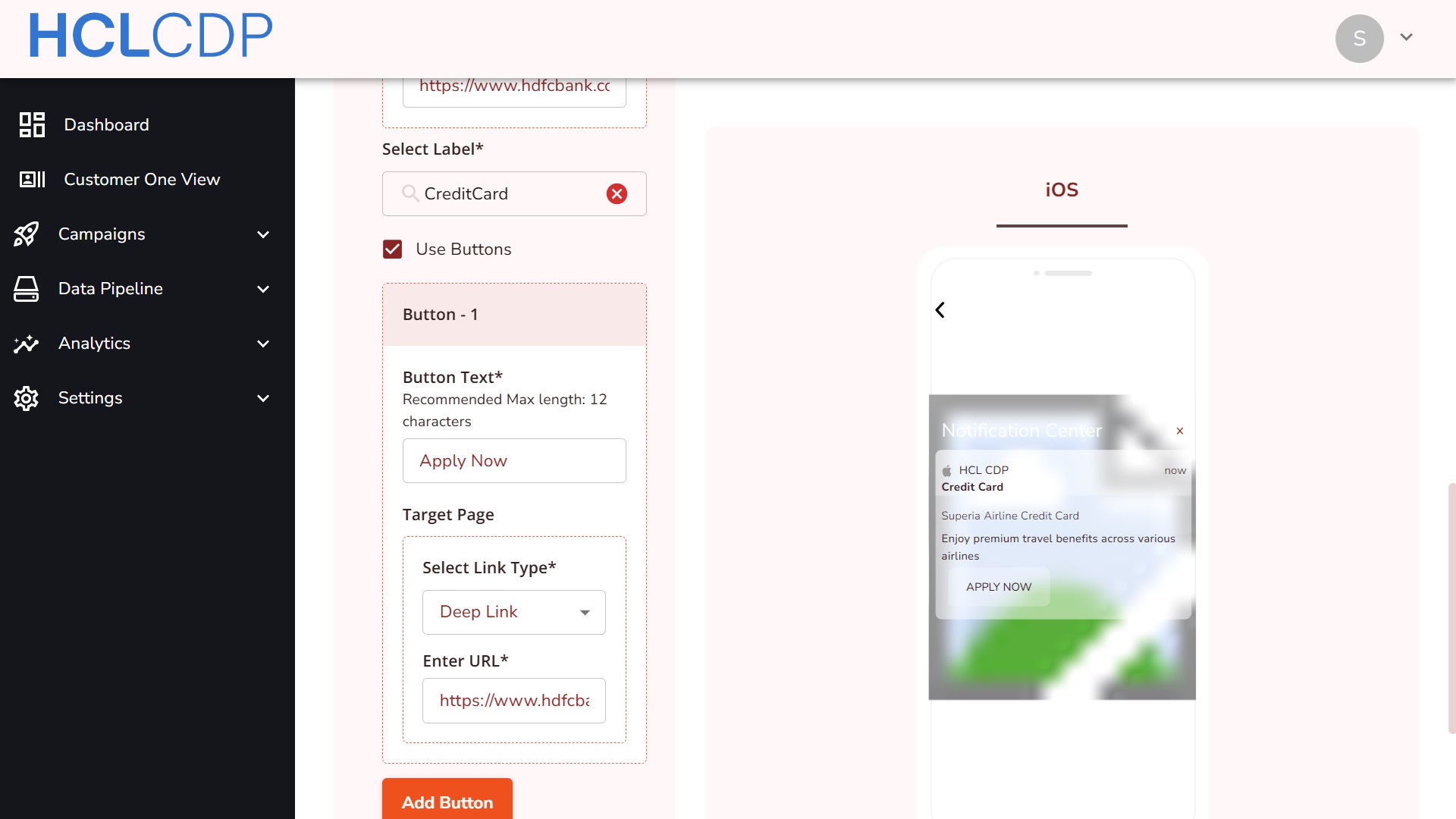

- Use Button: Select this checkbox to include buttons in the app push notification. Adding this button is optional, and you can add up to 3 buttons.
- Button Text (mandatory): Enter a name for the button.
- Target Page:
- Select Link Type (mandatory): Select a link type either URL or deep link to perform the required function.
- Enter URL (mandatory): Enter the URL of the target page to
redirect the user to a URL in the browser.
- Deep Link - Enter URL (mandatory): Enter the URL for a
specific activity within the application to redirect users to a
particular screen on the application.

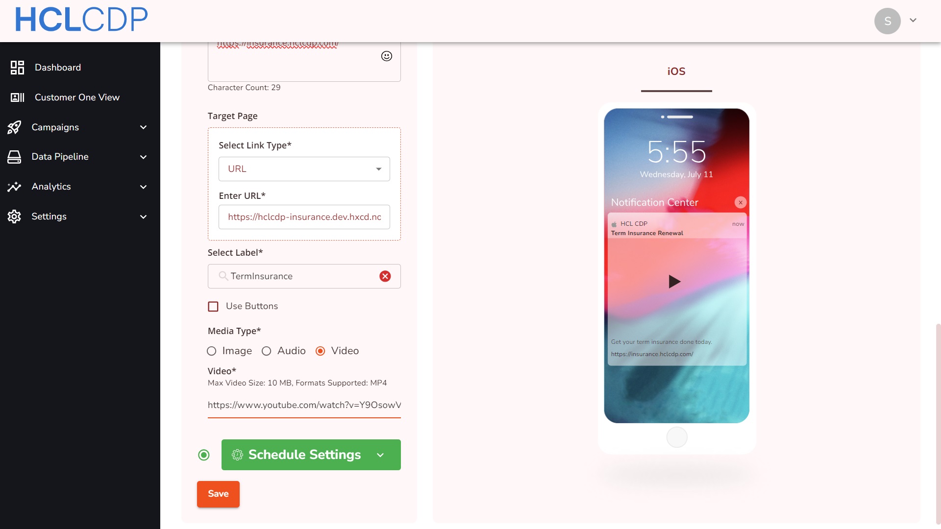

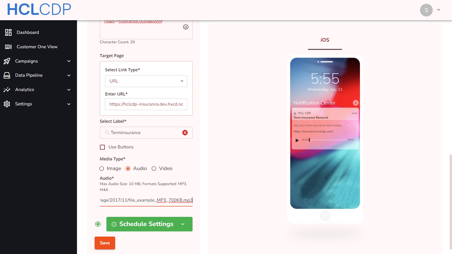

Upload Image (mandatory): Upload an image of the following dimensions:
- Aspect Ratio: 2:1
- Max Size: 10 MB
- Supported File Formats: JPG, JPEG, PNG, GIF, WEBP
Audio (mandatory): Enter the URL of an audio file of the following dimensions:
Enter the URL of the audio file hosted on your server or any other public server accessible by HCL CDP.Note:
- Uploading audio or video files is not supported.
- The audio file should not be a YouTube or Vimeo link.
- The file size must not exceed 10 MB.
- Supported File Formats: MP3, M4A
Video (mandatory): Enter the URL of the video of the following dimensions:
Enter the URL of the video file hosted on your server or another public server accessible by HCL CDP.Note:
- The video file should not be a YouTube or Vimeo link.
- Supported File Format: MP4
