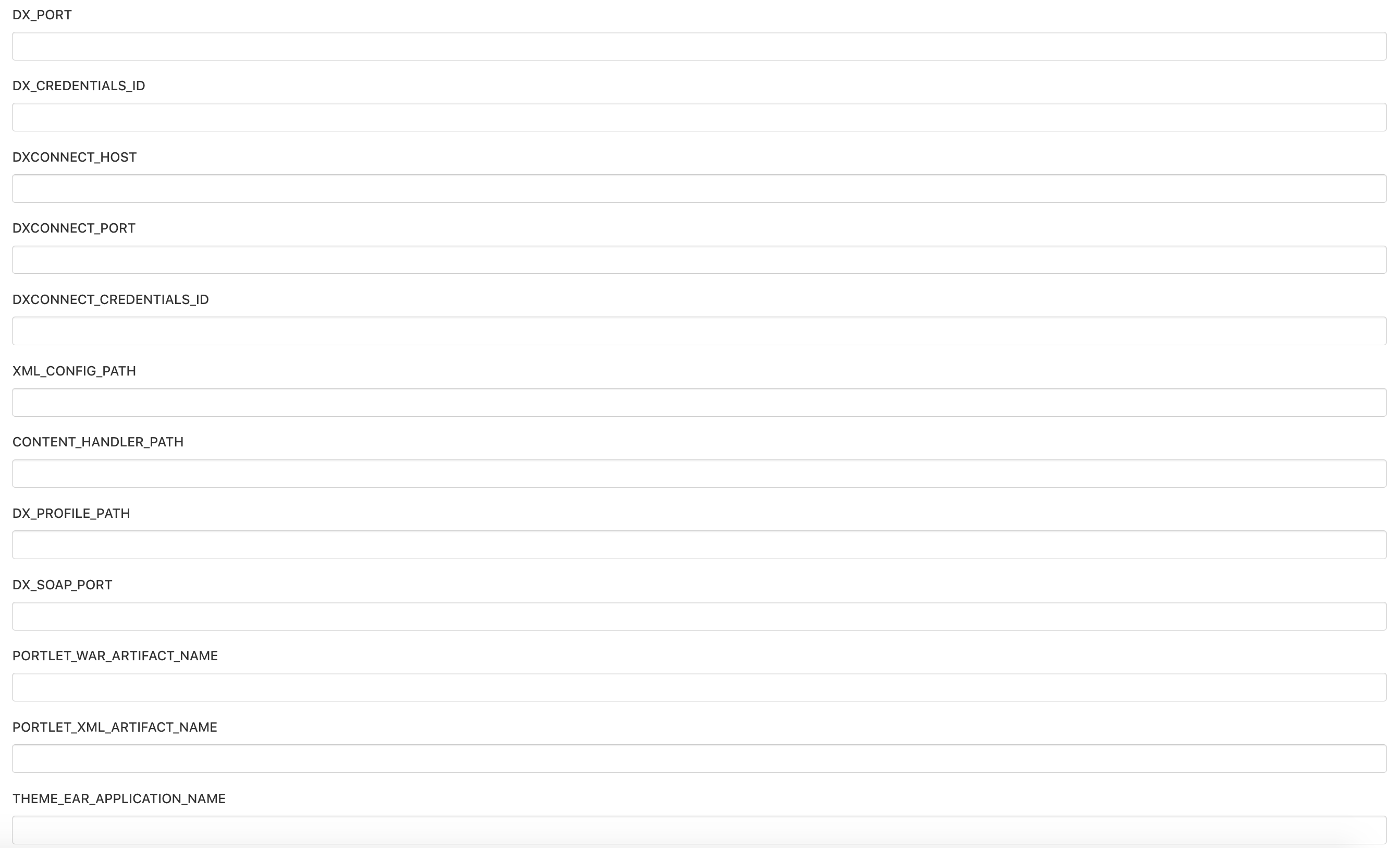

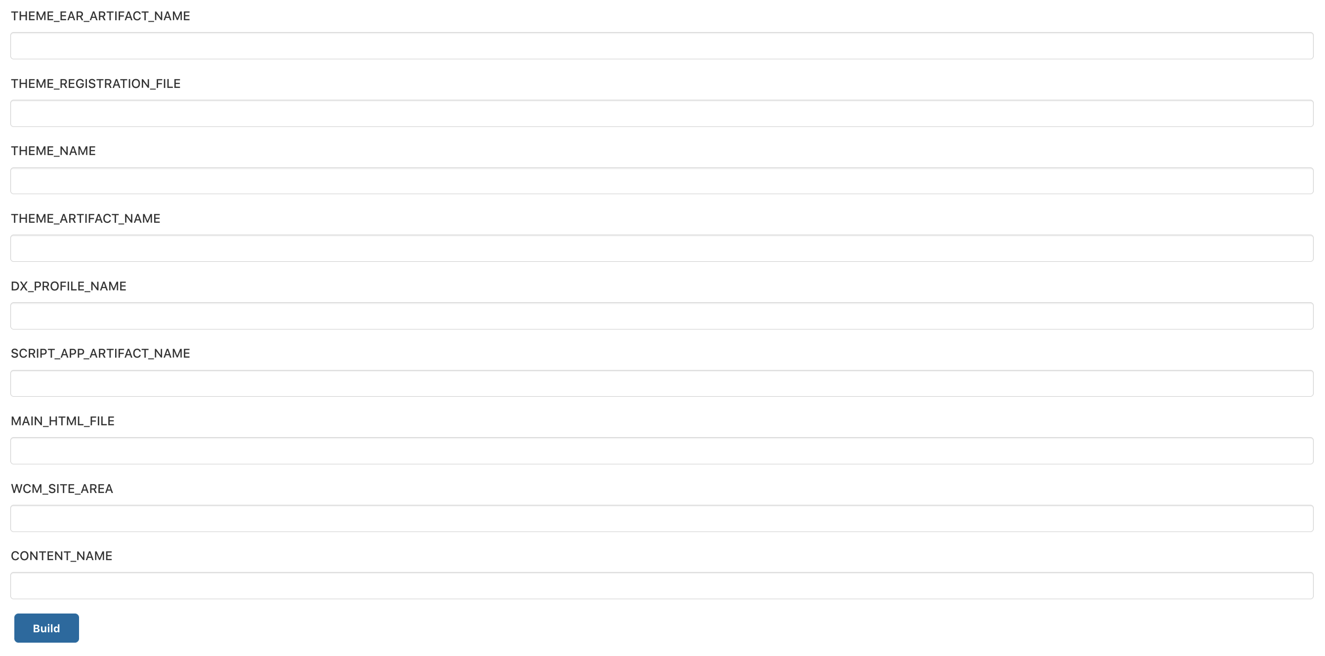

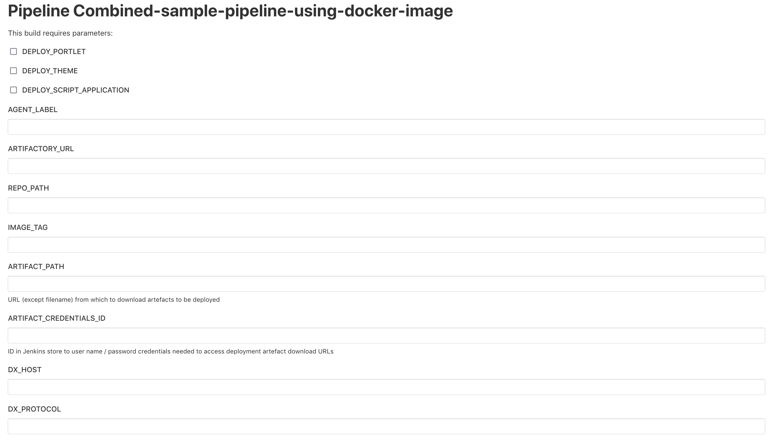

This sample shows how to pull DXClient docker image from the given artifactory, run the DXClient tool in the docker and then deploy a portlet, theme, and script application. It is designed to be run from a Jenkins job that provides the following parameters:
| Parameter | Value | Notes |
DEPLOY_PORTLET |
Select this to deploy the portlet | |
DEPLOY_THEME |
Select this to deploy the theme | |
DEPLOY_SCRIPT_APPLICATION |
Select this to deploy the script application | |
AGENT_LABEL |
Jenkins agent label | Determines on which agents the pipeline can run |
ARTIFACTORY_URL |
URL to DXClient docker image file | Docker image will be pulled out from this URL |
REPO_PATH |
Repository path of the DXClient docker image | Docker image will be pulled out from this folder |
IMAGE_TAG |
docker image tag | Docker image will be pulled out using this image tag |
ARTIFACT_PATH |
URL (except filenames) for artifacts to be deployed | Artifacts fetched via curl |
ARTIFACT_CREDENTIALS_ID |
Credentials ID in Jenkins store | User name / password credentials needed to access artifact URLs |
DX_HOST |
Host name or IP address of DX server | Artifacts will be deployed to this server |
DX_PROTOCOL |
Protocol to connect to DX server | http or https |
DX_PORT |
Port to connect to DX serve | Port for the DX main profile |
DX_CREDENTIALS_ID |
Credentials ID in Jenkins store | User name / password credentials needed to access DX server |
DXCONNECT_HOST |
Host name or IP address of the DXConnect servlet (route change only in case of Open Shift Kubernetes Environment. For other case, this parameter should be same as DX_HOST) | Hostname for the DX Configuration Wizard profile |
DXCONNECT_PORT |
Port to connect to DXConnect servlet | Port for the DX config wizard profile |
DXCONNECT_CREDENTIALS_ID |
Credentials ID in Jenkins store | User name / password credentials needed to access DX server config wizard profile |
XML_CONFIG_PATH |
URL path to the config servlet for xmlaccess | Defaults to '/wps/config' |
CONTENT_HANDLER_PATH |
Alternate path for the portal context root or the content handler servlet | Default to /wps/mycontenthandler/ |
DX_PROFILE_NAME |
Profile name of the DX server | |
DX_PROFILE_PATH |
Profile path of the DX server | |
DX_SOAP_PORT |
Soap Port number of the DX server | |
PORTLET_WAR_ARTIFACT_NAME |
Filename of WAR to deploy the portlet | Required for deploy portlet |
PORTLET_XML_ARTIFACT_NAME |
Filename of xmlaccess script used to deploy the portlet | Required for deploy portlet |
THEME_EAR_APPLICATION_NAME |
Application name for the EAR file to deploy the theme | Required for EAR theme deployment |
THEME_EAR_ARTIFACT_NAME |
File name of EAR application to deploy theme | Required for EAR theme deployment |
THEME_REGISTRATION_FILE |
File name of XML file to register the theme | Required for theme registration |
THEME_NAME |
WEBDAV theme name | Required for WEBDAV theme deployment |
THEME_ARTIFACT_NAME |
WEBDAV theme zip file name | Required for WEBDAV theme deployment |
SCRIPT_APP_ARTIFACT_NAME |
Filename of compressed script application to deploy | Required for deploy script application |
MAIN_HTML_FILE |
File name of Main HTML file within the script application | Required for deploy script application |
WCM_SITE_AREA |
SiteArea of the Script Application content | Required for deploy script application |
CONTENT_NAME |
Name of the Script Application instance to be created or updated | Required for deploy script application |
