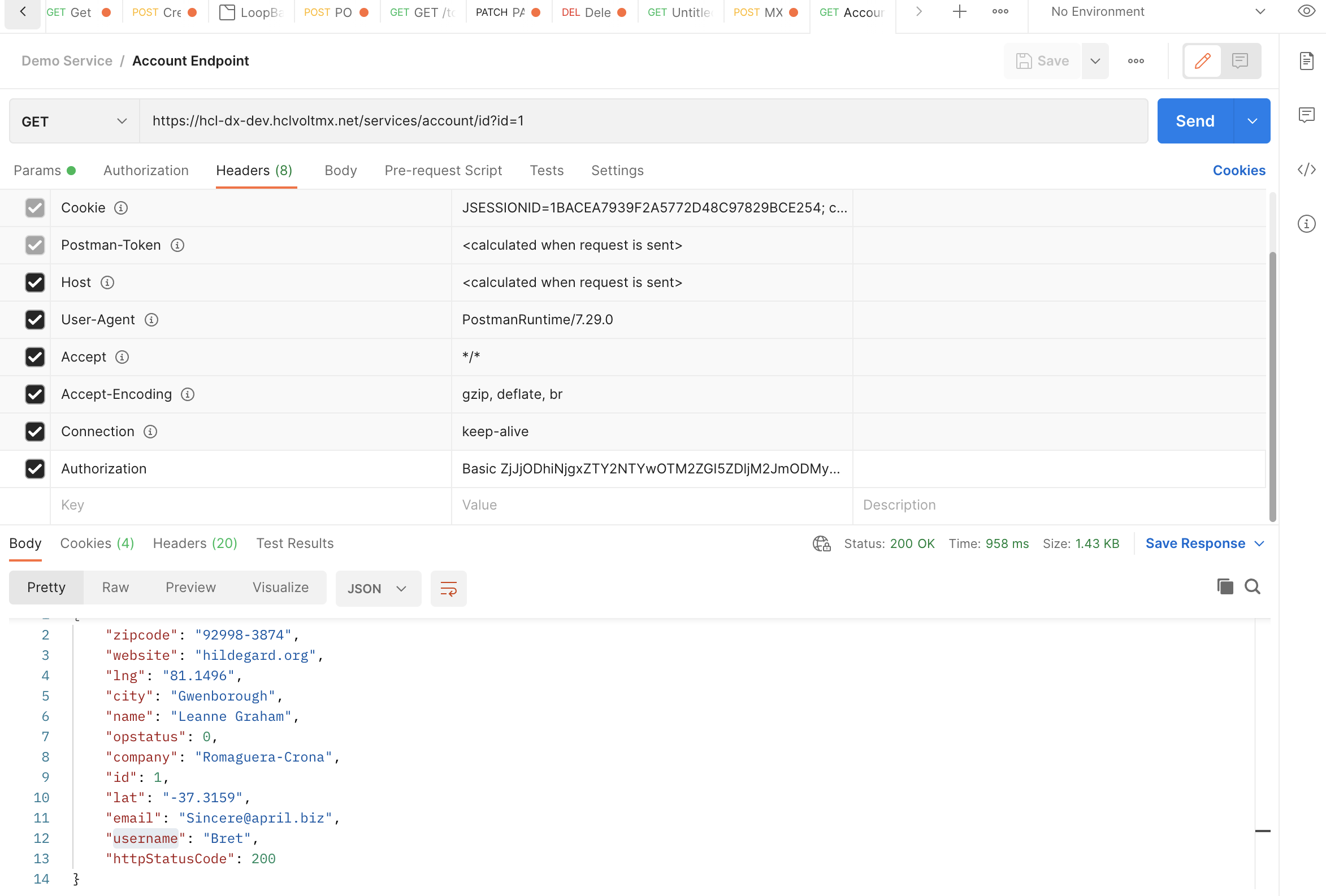

  • Following API end point and response are used to create this sample document.

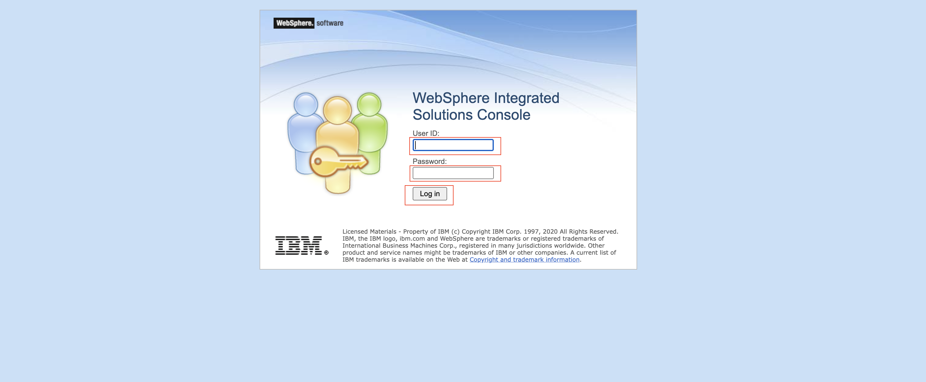

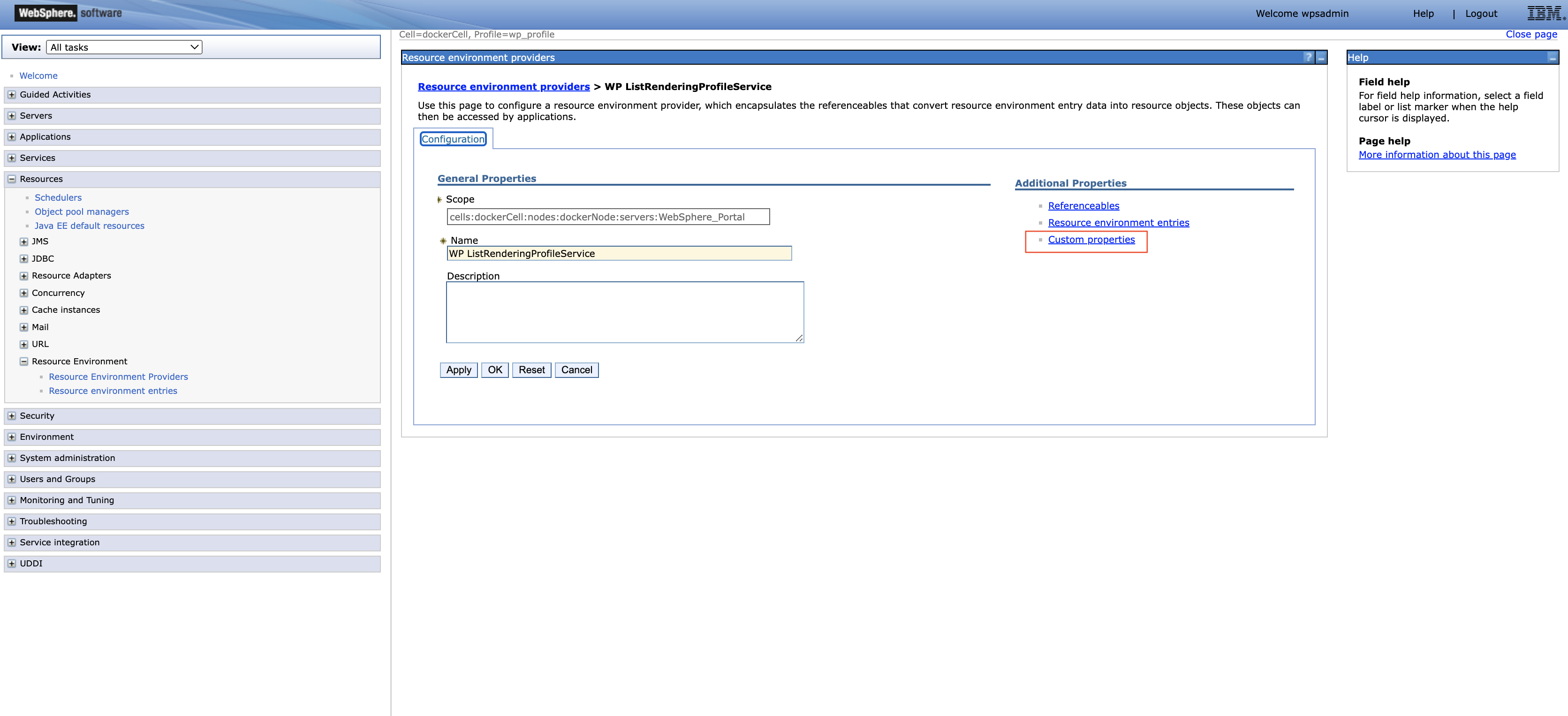

  1. Log in to the WAS console.

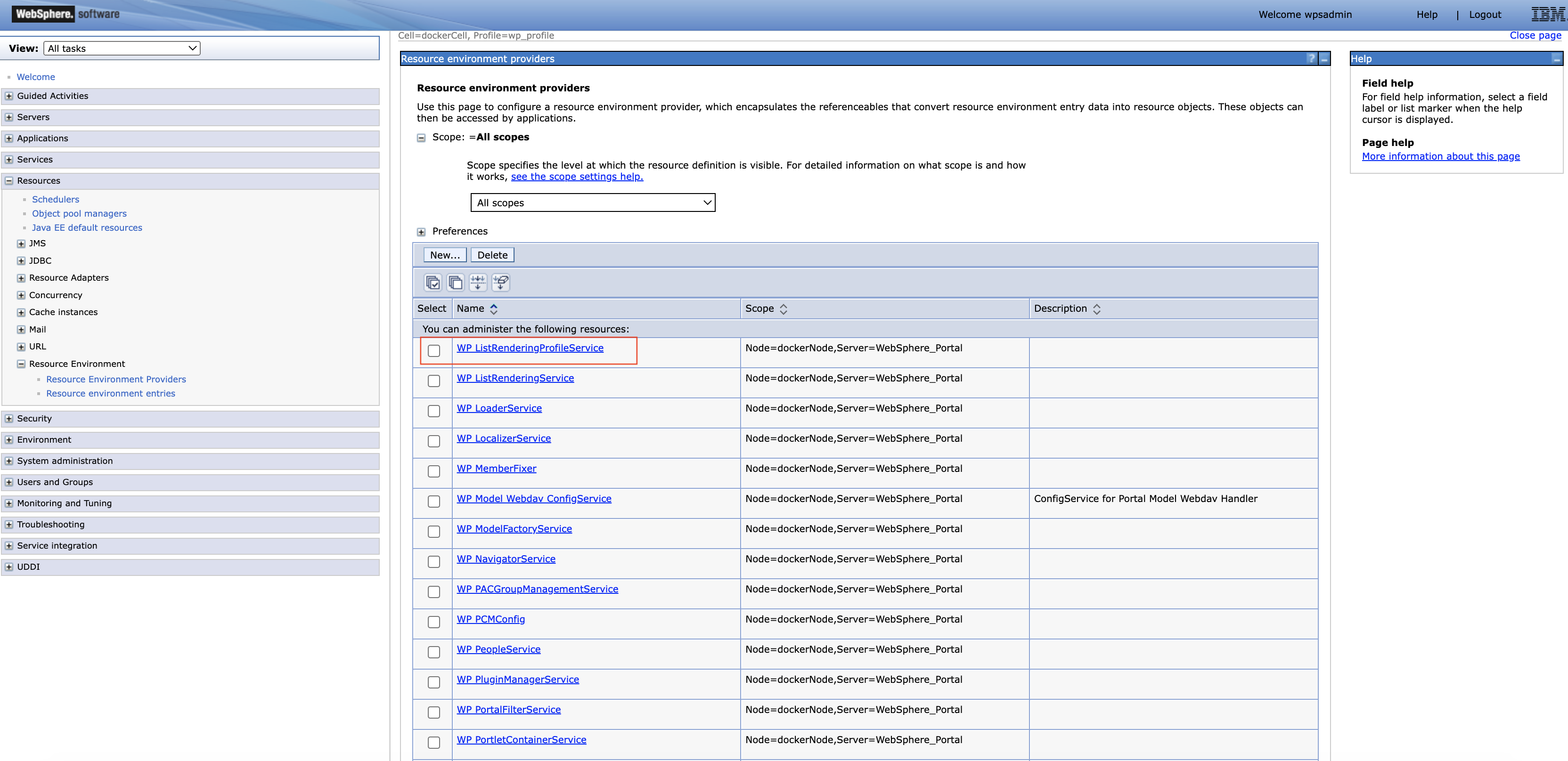

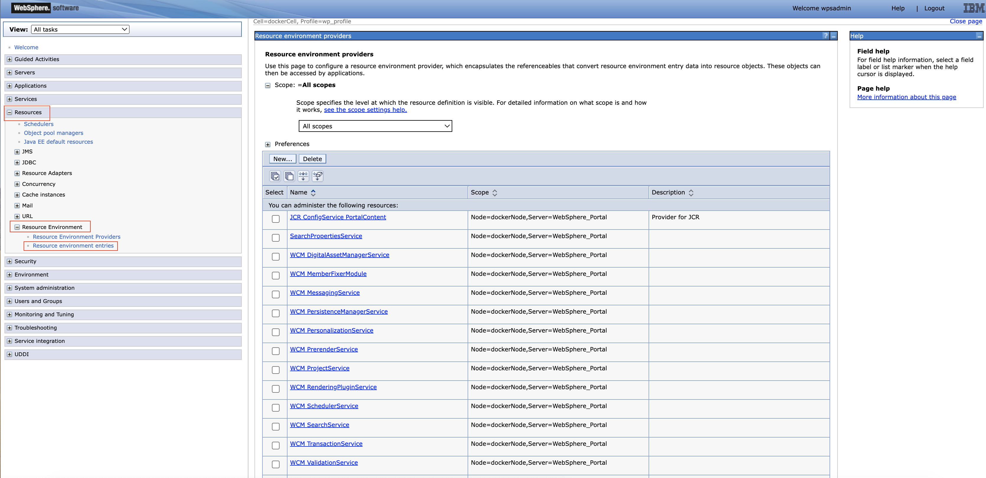

  2. Click Resources from side navigation. Then, click Resource Environment, then Resource environment providers.
  3. From the list of resources, find WP ListRenderingProfileService and click.

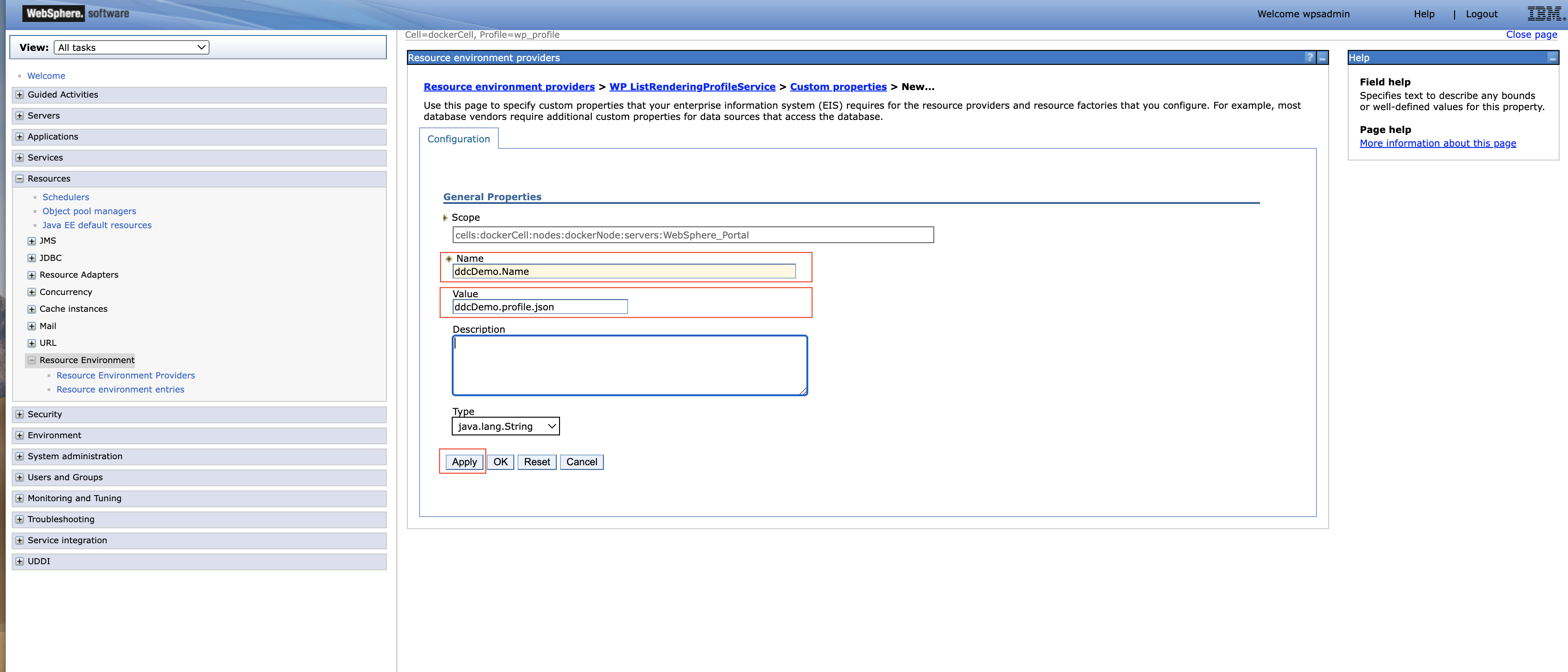

  4. Click Custom properties From the Additional Properties on right side.
  5. Click on New and add your unique profile (e.g. ddcDemo) and it's properties by entering name-value pairs like in the sample below. Click Apply then OK
    Name Value Type Description
    ddcDemo.Name ddcDemo.profile.json String The unique name of the list-rendering profile
    ddcDemo.BeanListProviderID ibm.portal.ddc.json String The name of the used DDC plugin
    ddcDemo.ItemAttribute.id id Integer This should be mapped to a unique identifier per record
    ddcDemo.ItemAttribute.fullname name String Mapping the name provided by the datasource to fullname in the list-rendering profile
    ddcDemo.ItemAttribute.email email String Mapping a simple field
    ddcDemo.ItemAttribute.username username String Mapping a simple field
    ddcDemo.ListItemSelection . String Provides the root node of the JSON response
    ddcDemo.Type BasicJSONSelection String Specifies that dot notation is being used by the plugin to access the fields

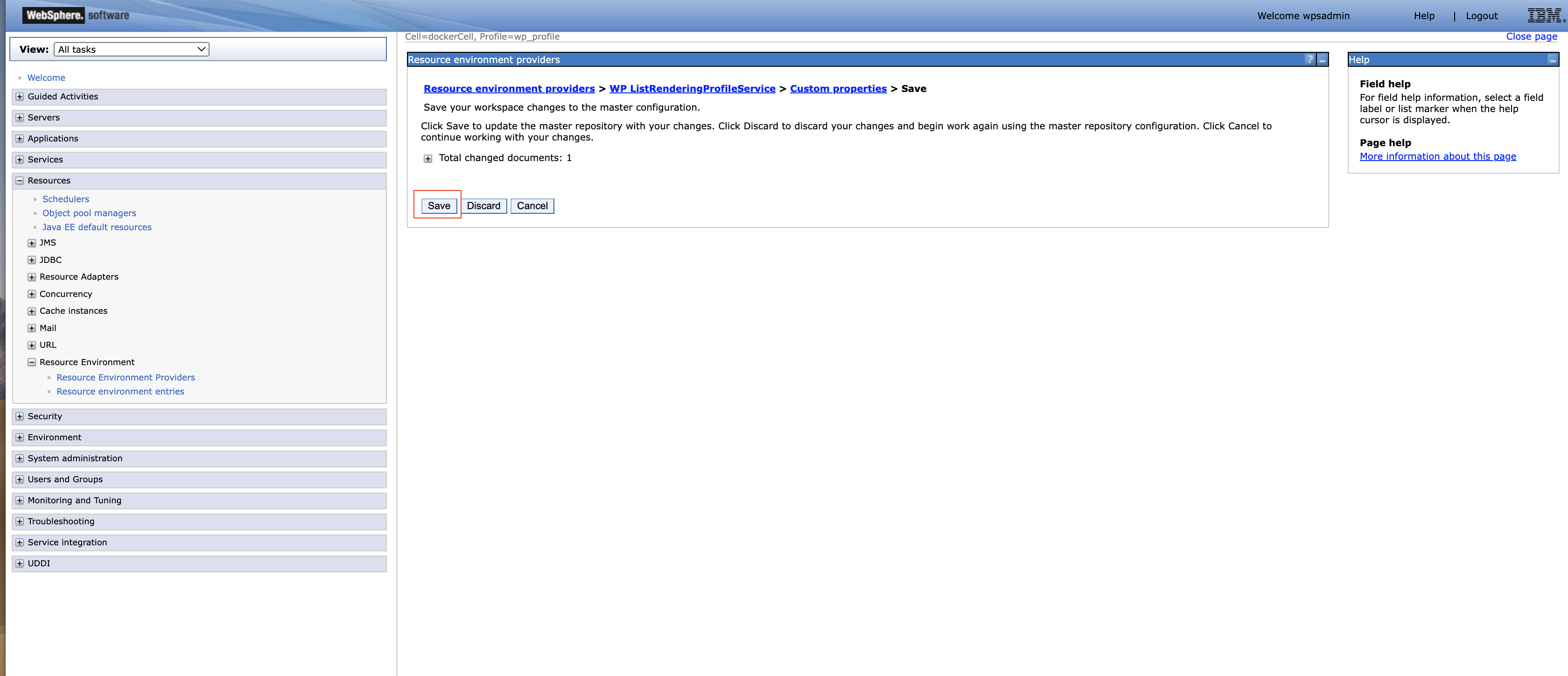

  6. Review and save the changes in the master configuration.
  7. Restart WAS server.

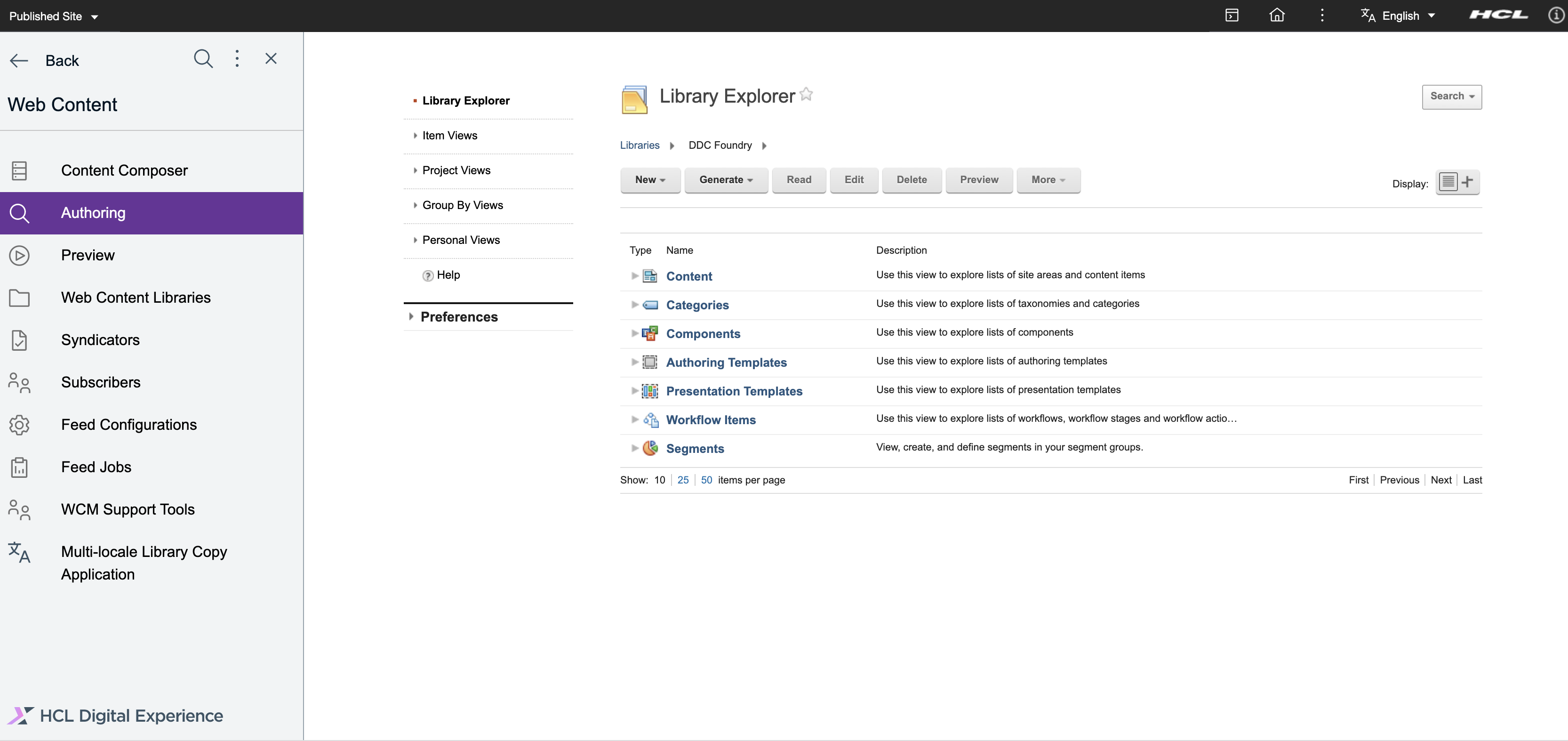

  1. Go to the Library Explorer, here you will see default items Content, Categories, Components, Authoring Templates, Presentation Templates,Workflow Items and Segments

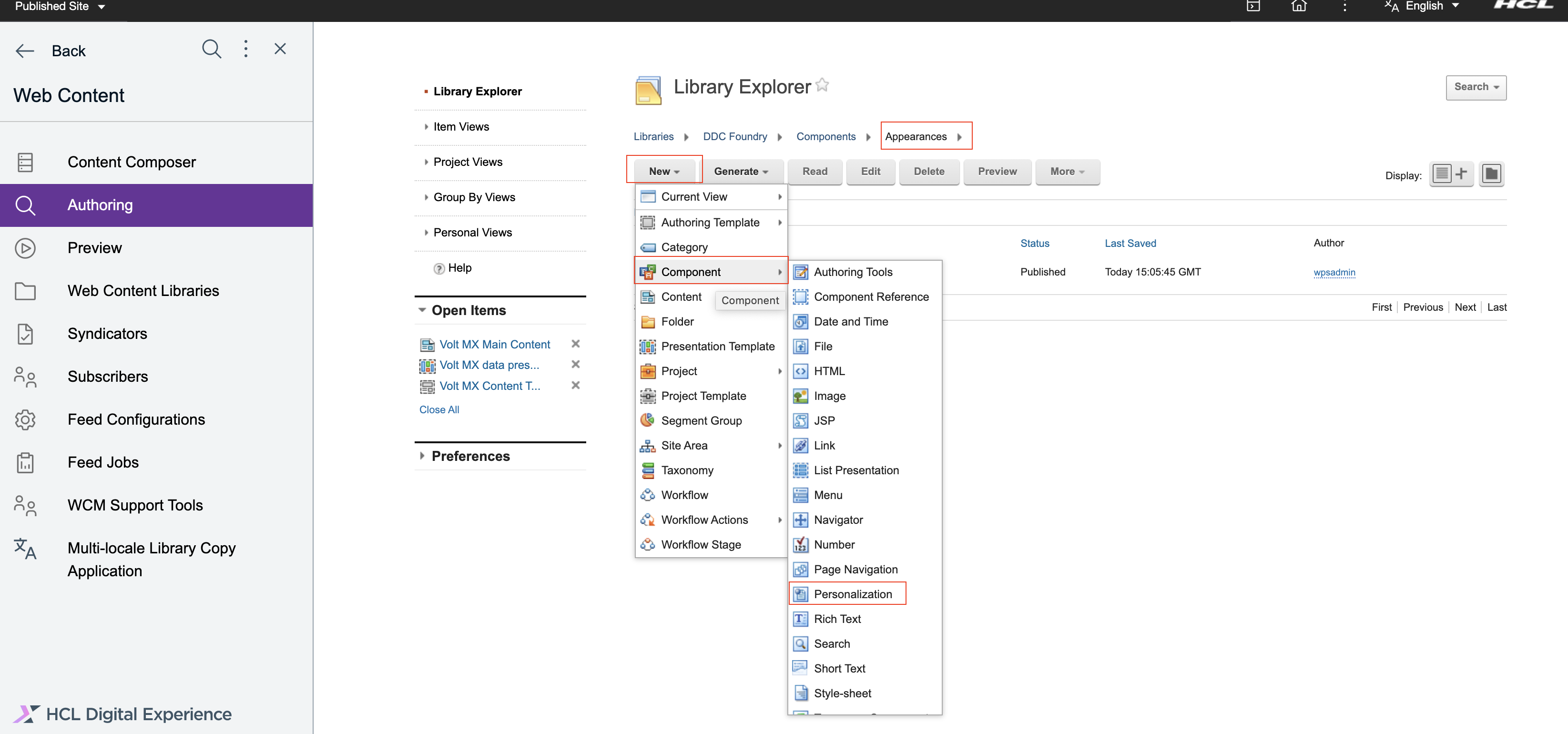

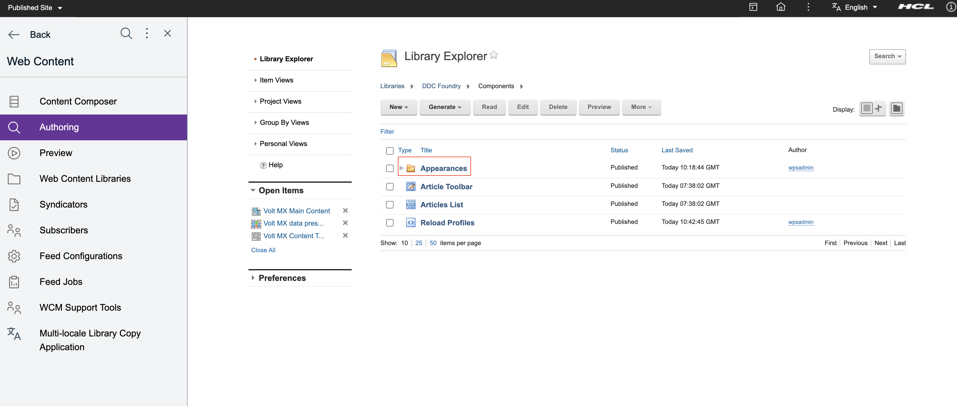

  2. Create an Appearances folder under Components. This is only so that your personalization components that uses the DDC selection rule Select pluggable resources can be found easily in one place.

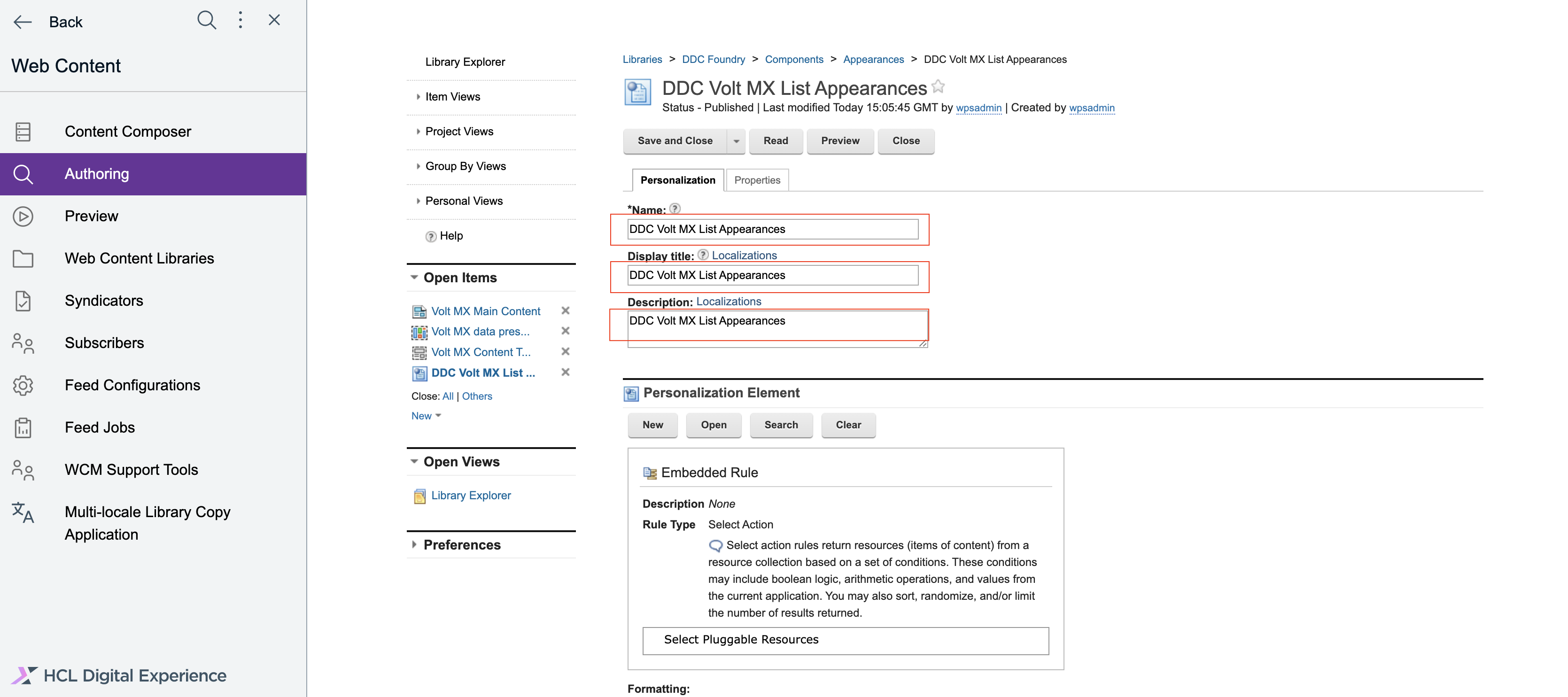

  3. Under Appearances folder, create a new Personalization component.
    • Click on New button. Then, click Component, then Personalization component
    • Enter the name and title. Suggested name: DDC Volt MX List Appearances

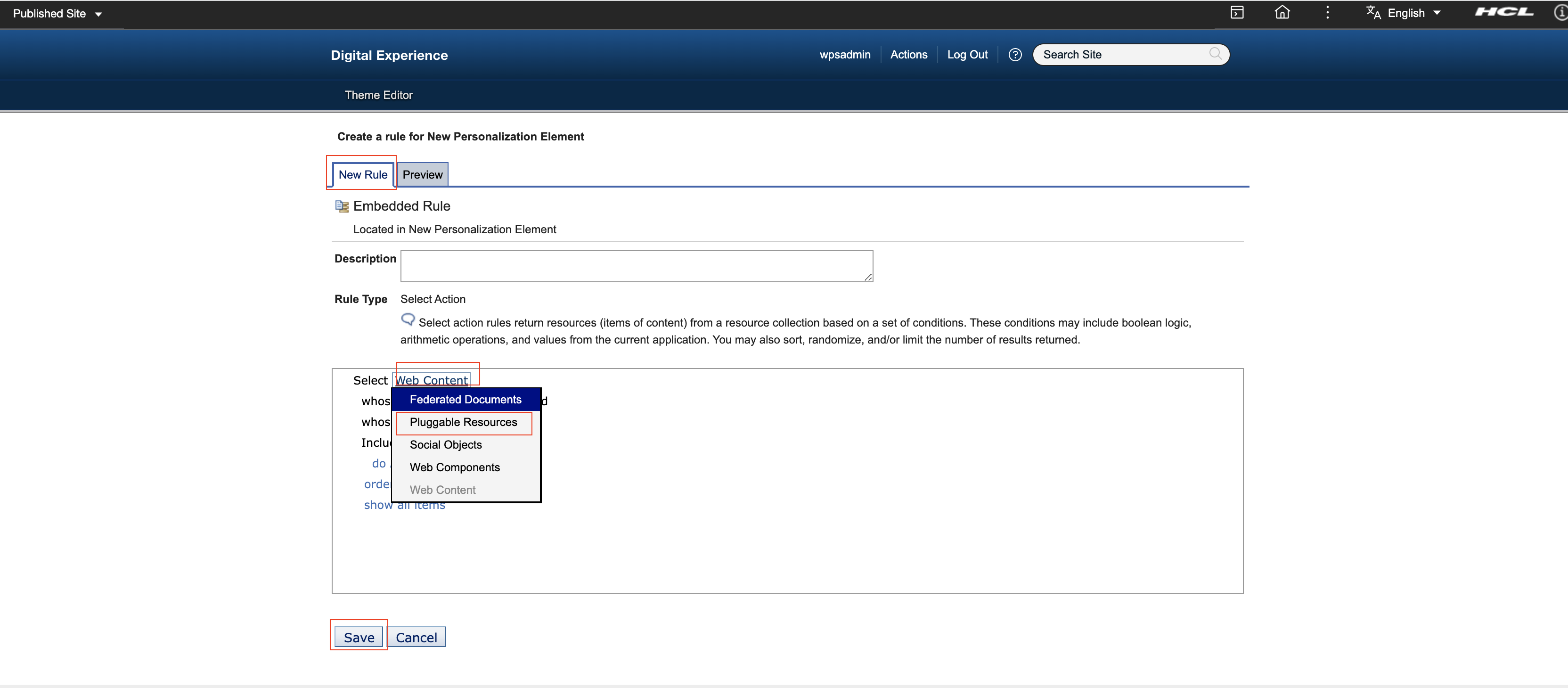

    • Under Personalization Element, click New. As a New Rule, instead of Select Web Content, click on the Web Content phrase and select Pluggable Resources instead and click Save.

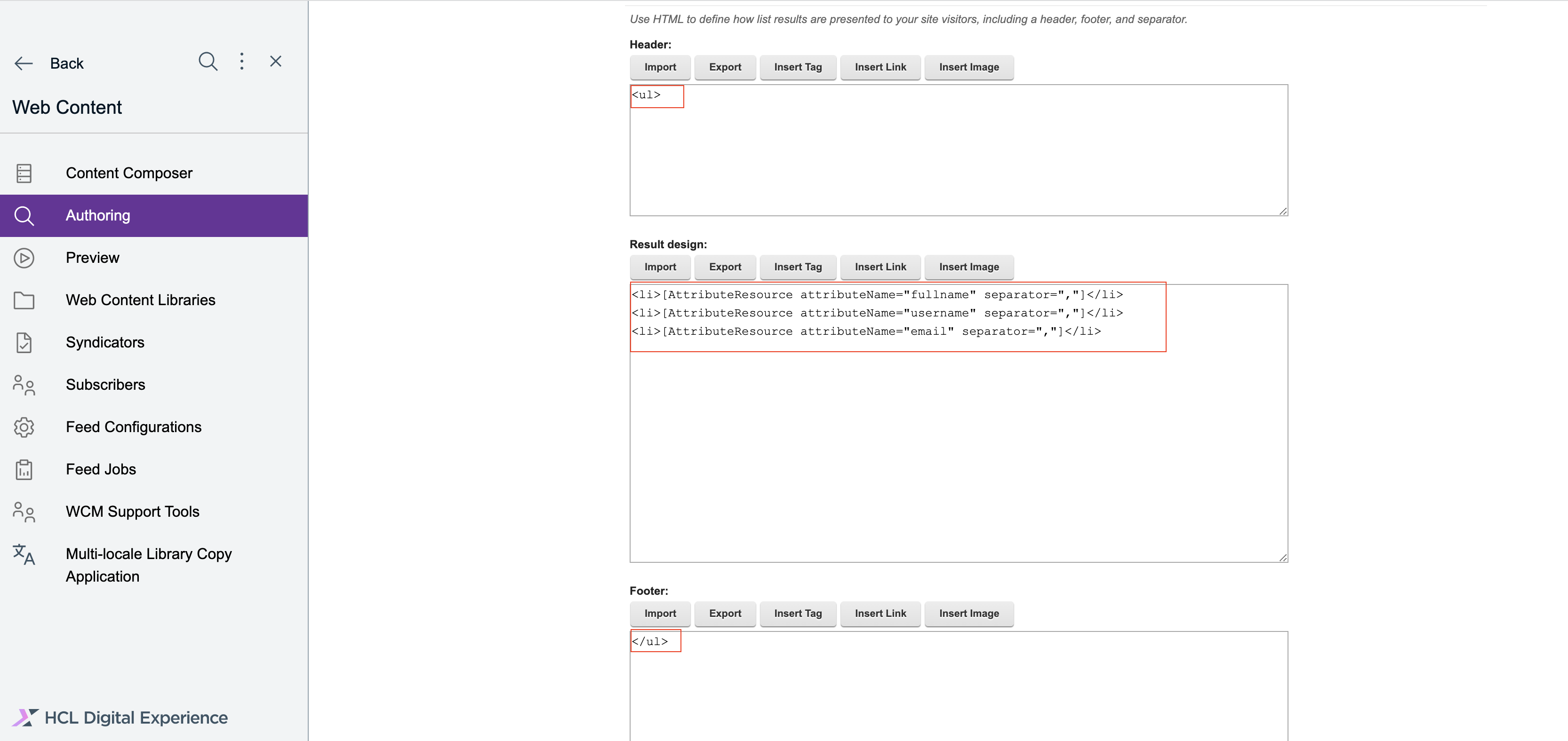

    • In the List Presentation Markup, add the following:
      • Header: <ul>
      • Body:
        <li>[AttributeResource attributeName="fullname" separator=","]
        <li>[AttributeResource attributeName="username" separator=","]
        <li>[AttributeResource attributeName="email" separator=","]
      • Footer: <\ul>
    • Click Save and Close.
Create Reload Profiles under Components:
This is a convenient way to ensure the List Rendering Profile custom properties you have added or may have updated since are reflected without restarting the server. Although, if all else fails, restart server is always there as an option.
  1. Under Components, click on New button. Then, click Component, then HTML component.
  2. Enter the name Reload Profilesand in the markup, add the following: [Plugin:ListRenderingContext key="id" action="reloadProfiles"]
  3. Click Save and Close.
  4. Preview.

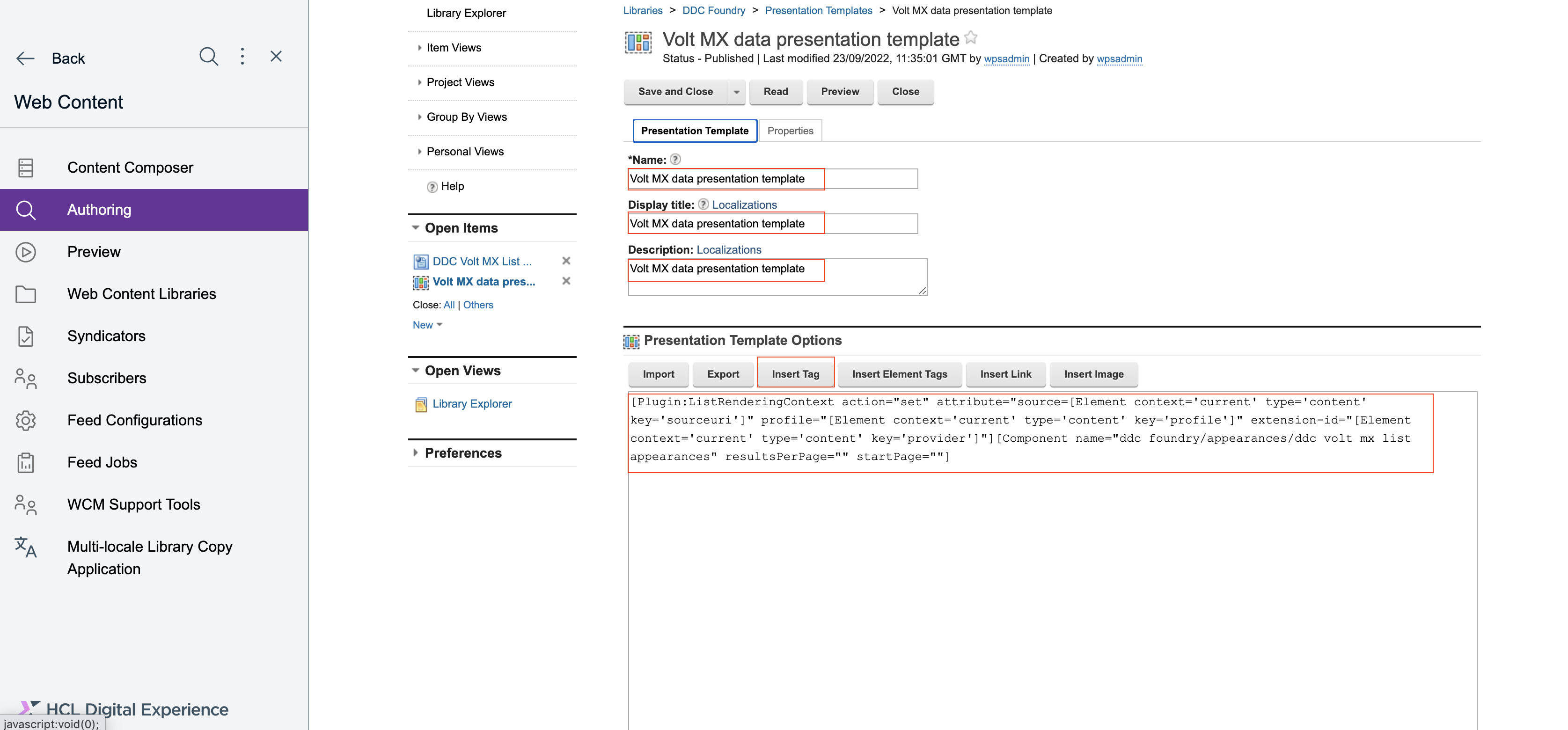

Create a Presentation Template
Set the context of the DDC content.
Steps to create Presentation Template are as follows:
  1. Create a new presentation template with suggested name Volt MX data presentation template and under presentation template options, add the following:
    [Plugin:ListRenderingContext action="set" attribute="source=[Element context='current' type='content' key='sourceuri']" profile="[Element context='current' type='content' key='profile']" extension-id="[Element context='current' type='content' key='provider']"]
    [Component name="ddc foundry/appearances/ddc volt mx list appearances" compute="always"]
    • Under attribute, define the data source endpoint. The content field set in this example is sourceuri, where you saved the endpoint in the content item.
    • profile refers to the List-Rendering Profile which was saved earlier in the WAS console. The content field that is set in this example is also profile, which is saved in the content item with the ddcDemo.profile.json value.
    • extension-id refers to the DDC plugin ID. The content field set in this example is provider, which is saved in the content item with value ibm.portal.ddc.json.
    • Save and close.

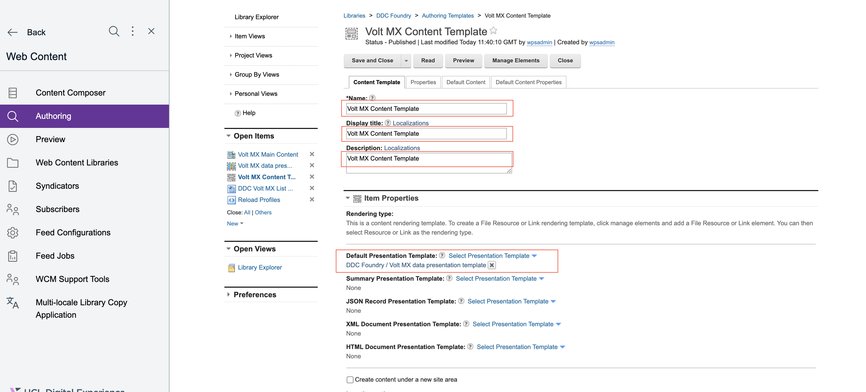

Create a Content Template
Under Authoring Templates, create a Content Template.
  1. Click on New button. Then, click Authoring Template, then Content Template component
  2. Add Name, Display title and Description with suggested name Volt MX Content Template. Then select the presentation template that was created earlier as the default presentation template Volt MX data presentation template.

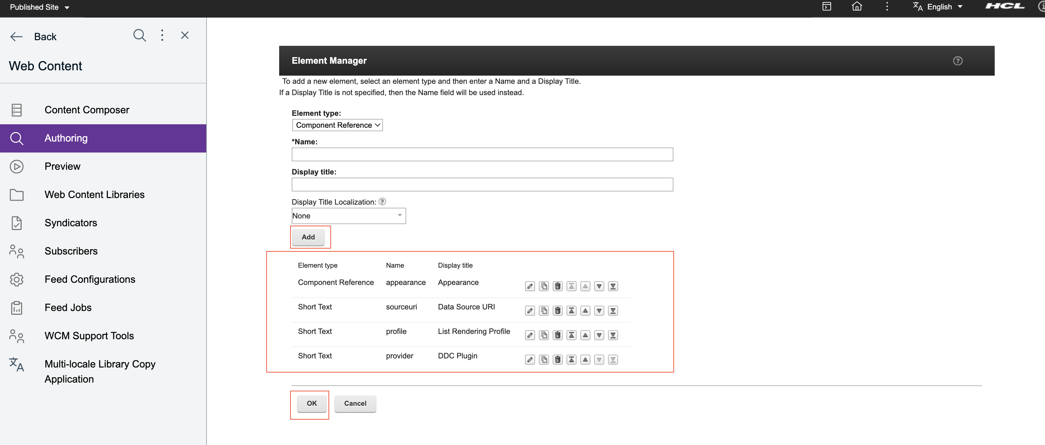

  3. Click on Manage Element and add the following elements to the content template as follows.
    Element type Name Display title
    Component Reference appearance Appearance
    Short Text sourceuri Data Source URI
    Short Text profile List Rendering Profile
    Short Text provider DDC Plugin

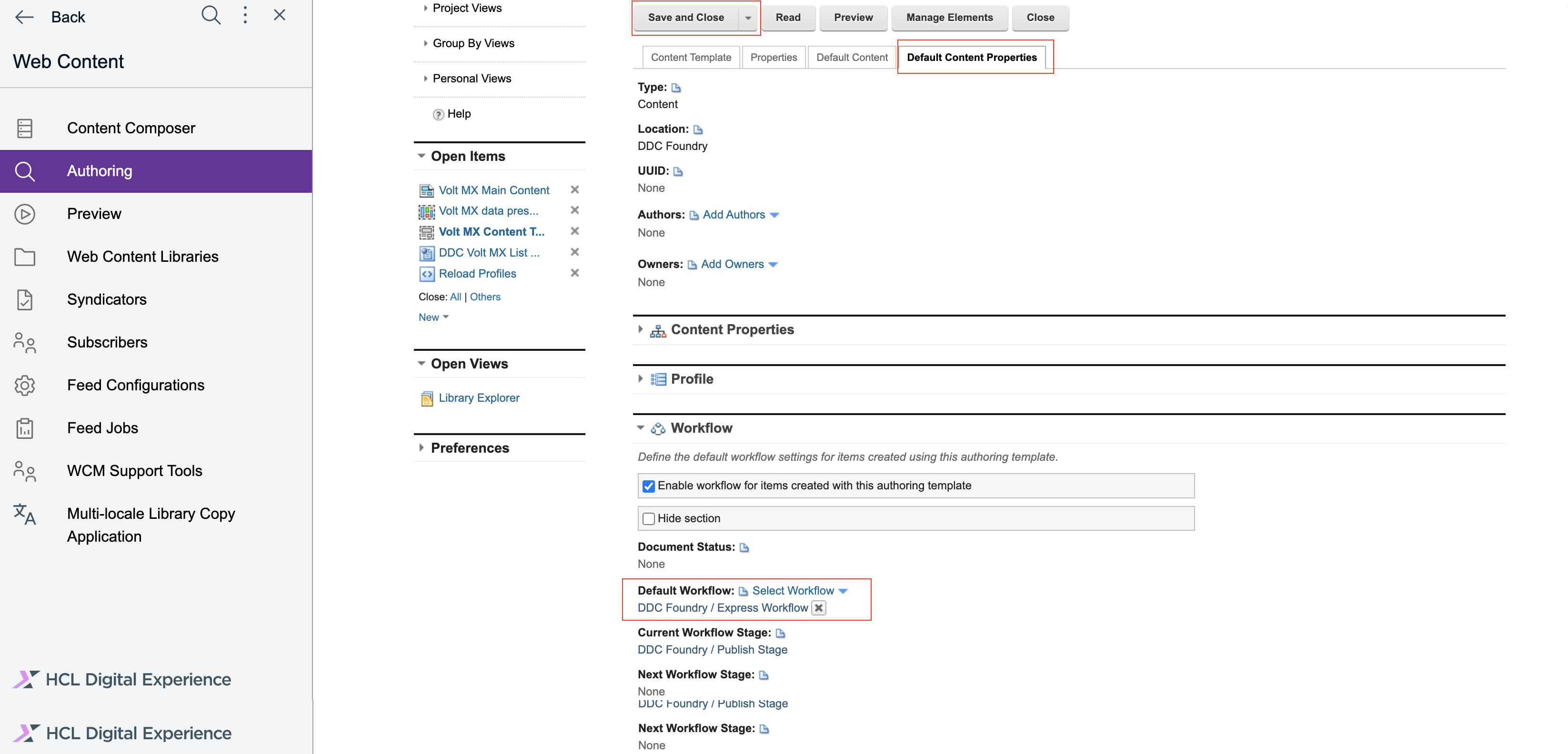

  4. Click on Default Content Properties and add Express workflow.
  5. Save and close.

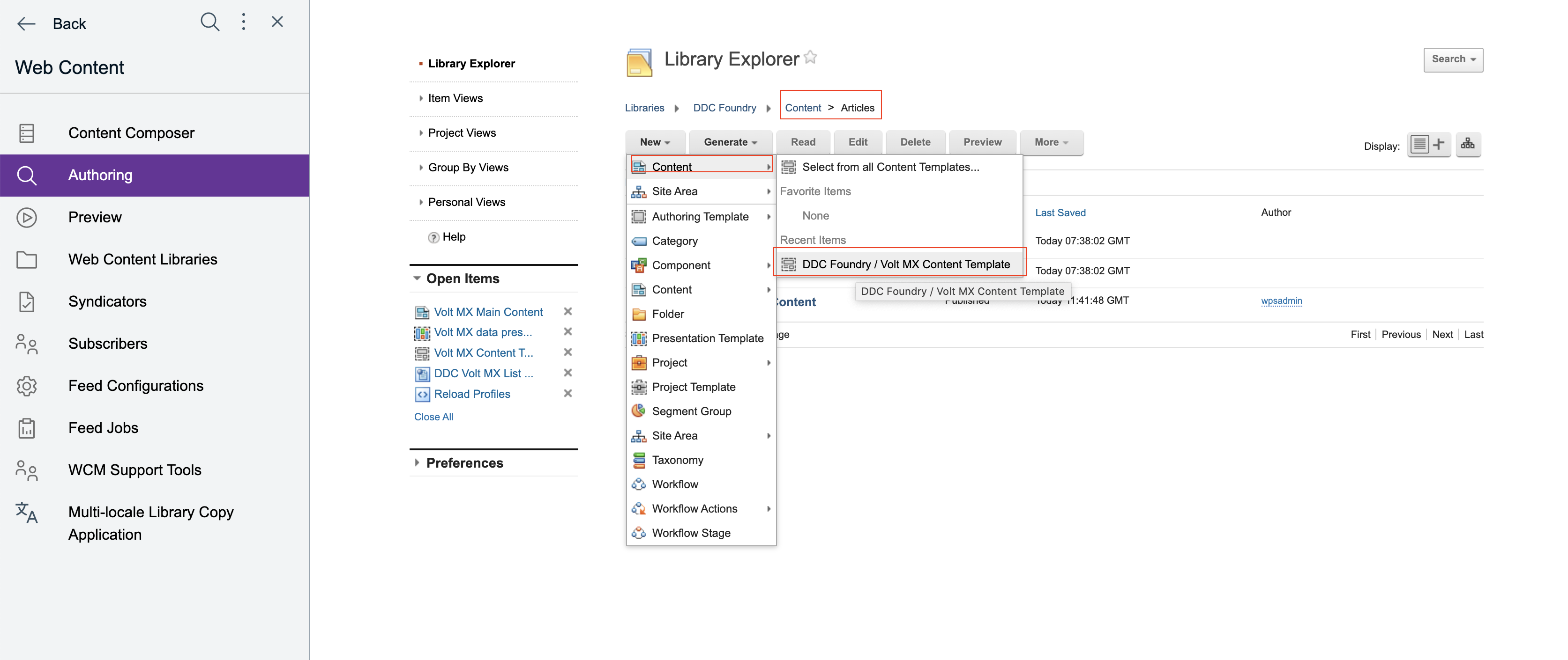

Create a Content item.

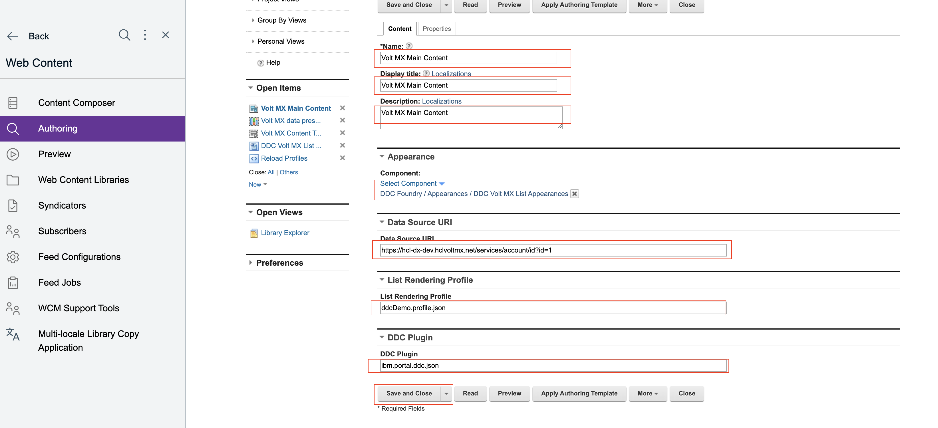

  1. Under your libraries, click Content, then click Articles, and create a new Content from the Content Template that you created earlier.
  2. Add Name, Display title, and Description with suggested name Volt MX Main Content, and in the content fields / elements, provide the following inputs:
    Content field title Value
    Appearance appearance
    Data Source URI https://hcl-dx-dev.hclvoltmx.net/services/account/id?id=1
    List Rendering Profile ddcDemo.profle.json
    DDC Plugin ibm.portal.ddc.json
  3. Save and close.

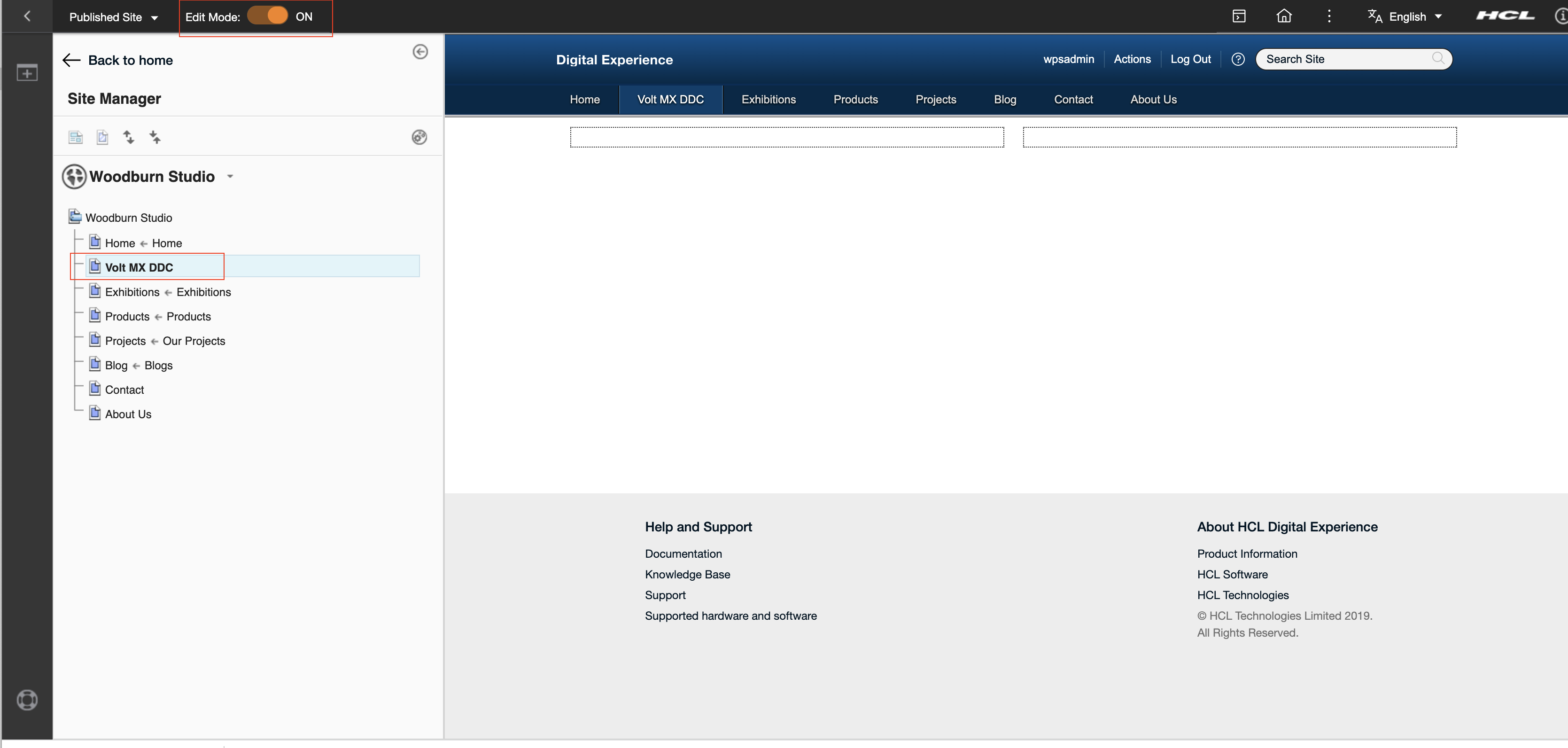

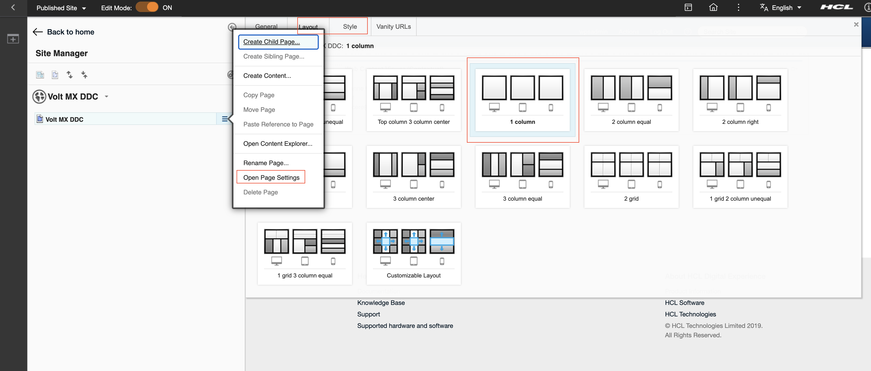

  1. Under Administration > Site Management > Manage Pages, create a new page under Content Root (e.g. Volt MX DDC page).
  2. Go to the page Volt MX DDC, and enable Edit mode.
  3. Choose the layout and style of the page.

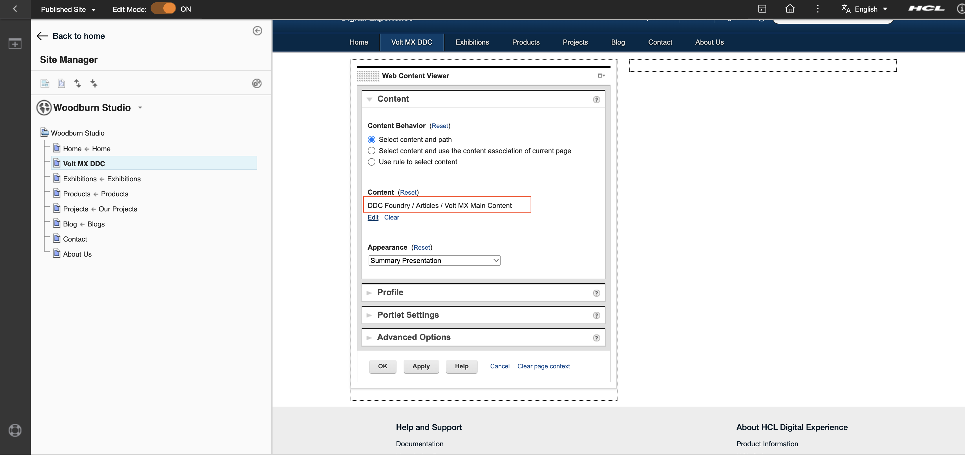

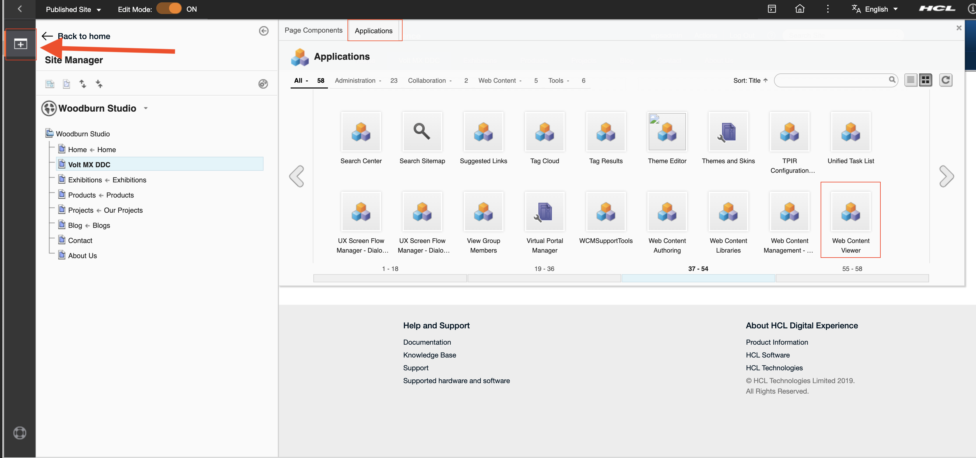

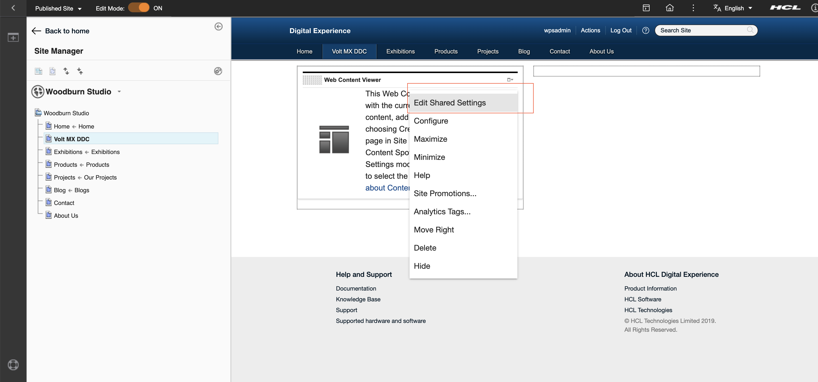

  4. Click on plus icon in left navigation panel. Then click on Applications and add a Web Content Viewer on the page.
  5. Inside the Web Content Viewer, click on the upper right dropdown button and select Edit Shared Settings.
  6. Under Content, change the mapped content to the Content Item you created above.

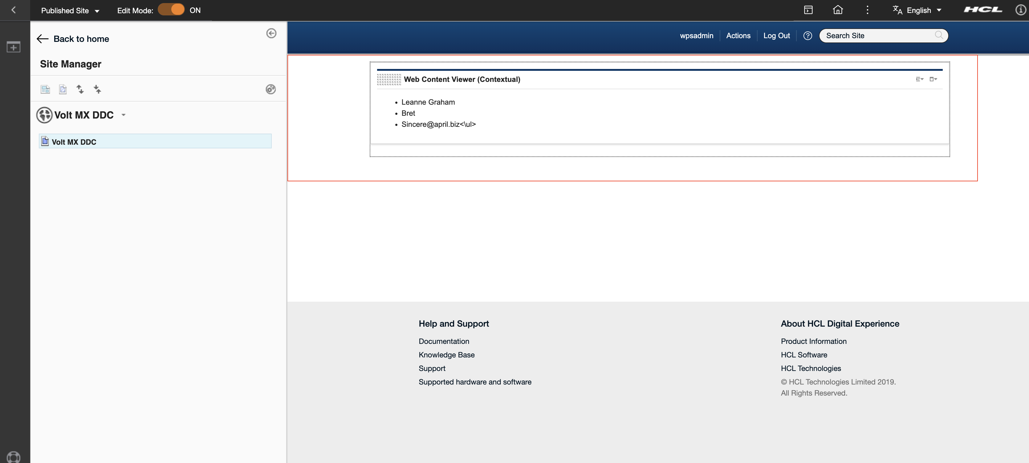

  7. Click OK, and the following output page will be displayed.
