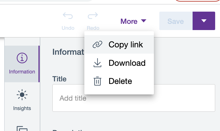

In contrast, a binaryUrl you get from Copy link on the Edit page, consists of a string of characters representing the collection_id, item_id, and rendition_id.
Sample binaryUrl:
/collections/5c11a585-c8e6-4ef7-ba6b-6c79977ee408/items/e0a81aeb-86bb-42a8-8287-338a65e13db1/renditions/8b5e2885-e7ca-4a68-83ed-24faf58ca574?binary=true

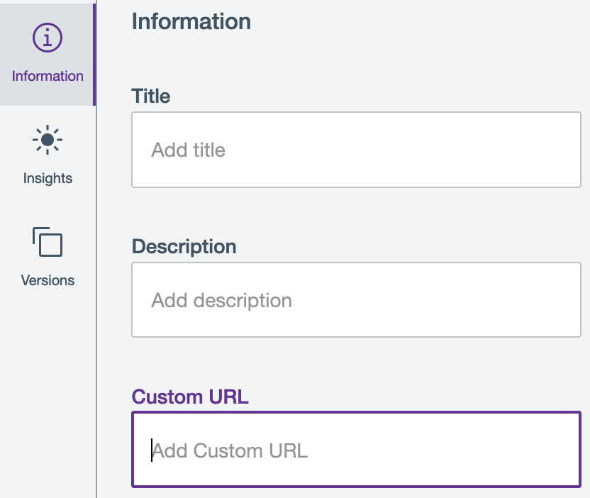

Meanwhile, a customUrl provides the original rendition of an asset. The customUrl is not related to a friendly URL.
Sample customUrl:
https://sample-url.com/dx/api/dam/custom/car
