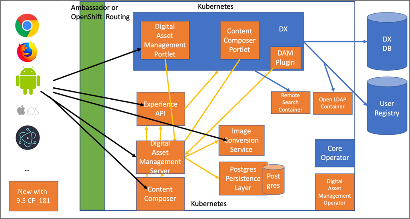

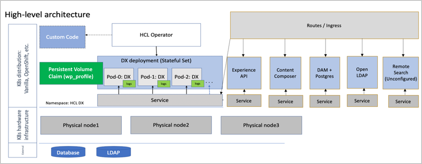

This section provides a high-level overview of the architecture and the steps to install, configure, and update the HCL Digital Experience 9.5 components: Experience API, Content Composer, and Digital Asset Management.
High-level architecture and topology
Prerequisite
DX Administrators can choose to install the DX Core containers and then proceed to install Content Composer and Digital Asset Management containers to the supported Kubernetes container platforms as outlined in the following steps. See the Deployment section for the latest DX 9.5 container file listings.
