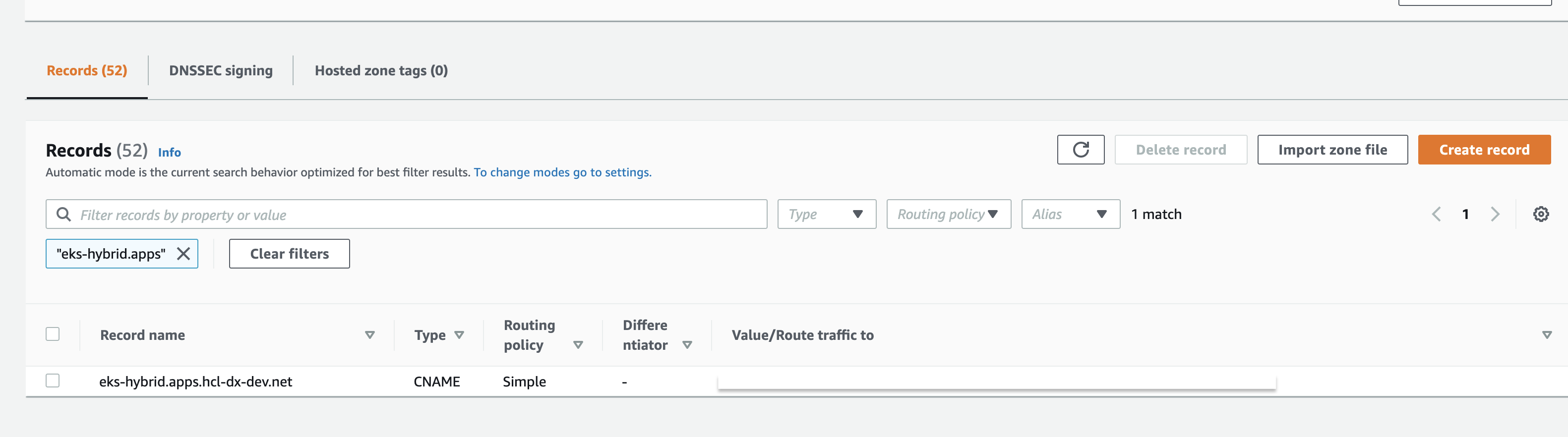

For Amazon EKS, you must add the external IP to route53.
