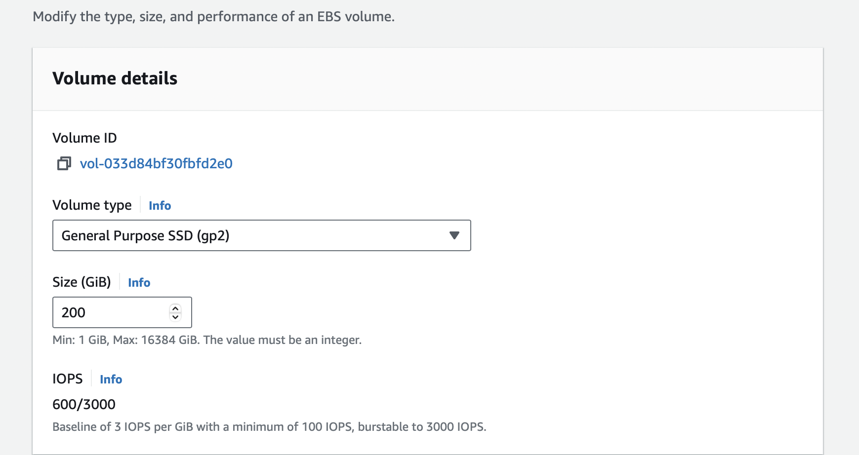

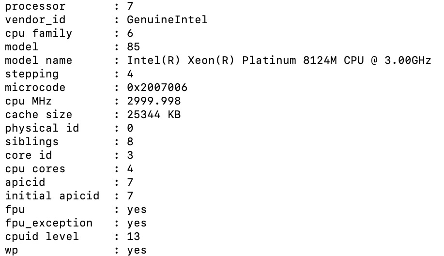

The Kubernetes platform ran on an Amazon EC2 instance with the DX images installed and configured. In AWS/Native Kubernetes, the tests were executed in EC2 instances with one c5.2xlarge node. Refer to the following node setup details:
c5.2large node
Node details
Processor details
Volume details

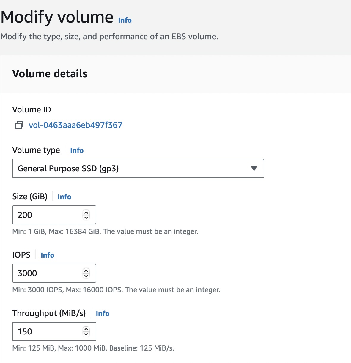

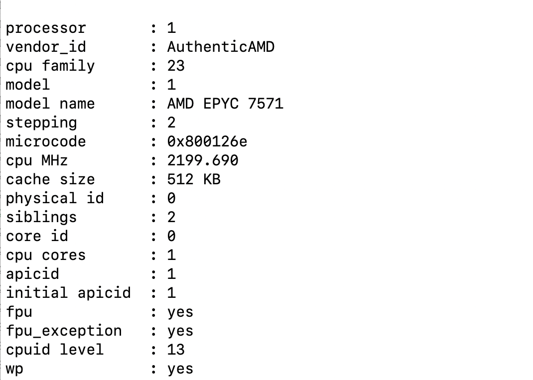

The tests used a c5.2xlarge remote DB2 instance for the core database. Refer to the following DB2 setup details:
DB2 details
Processor details
Volume details

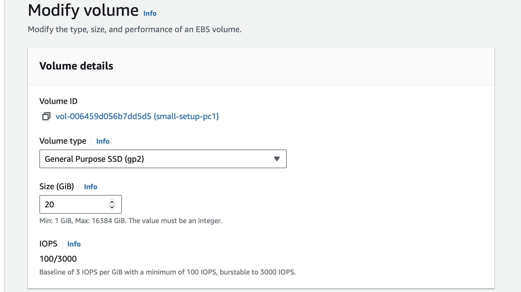

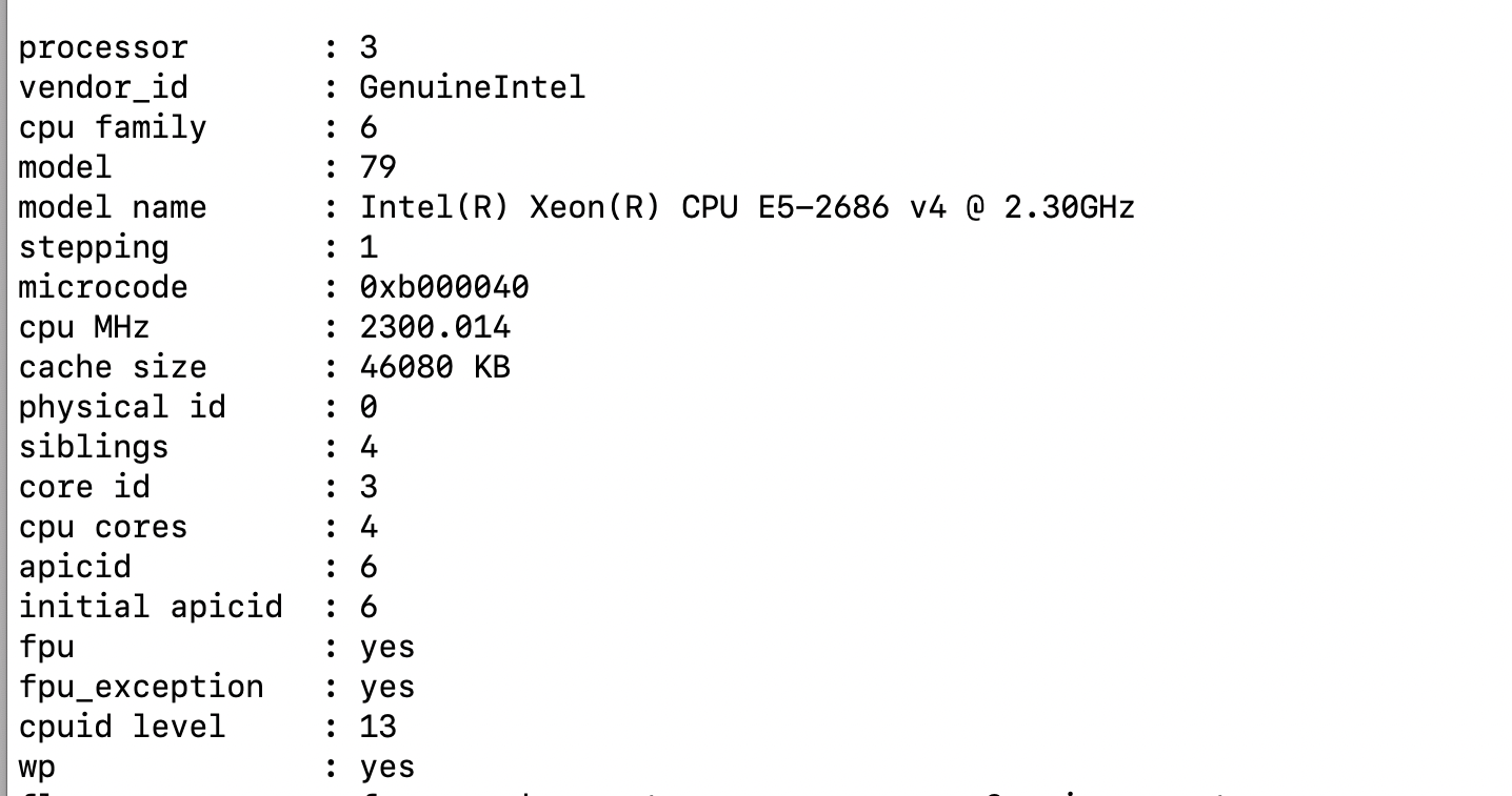

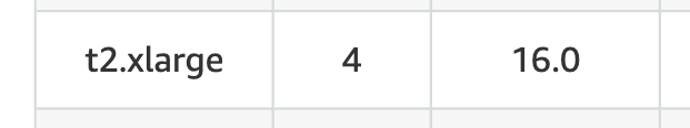

To run the tests, a distributed AWS/JMeter agents setup consisting of one primary and two subordinate t2.xlarge instances was used. Refer to the following JMeter setup details:
t2.xlarge JMeter instance
Instance details
Processor details
Network details
Volume details

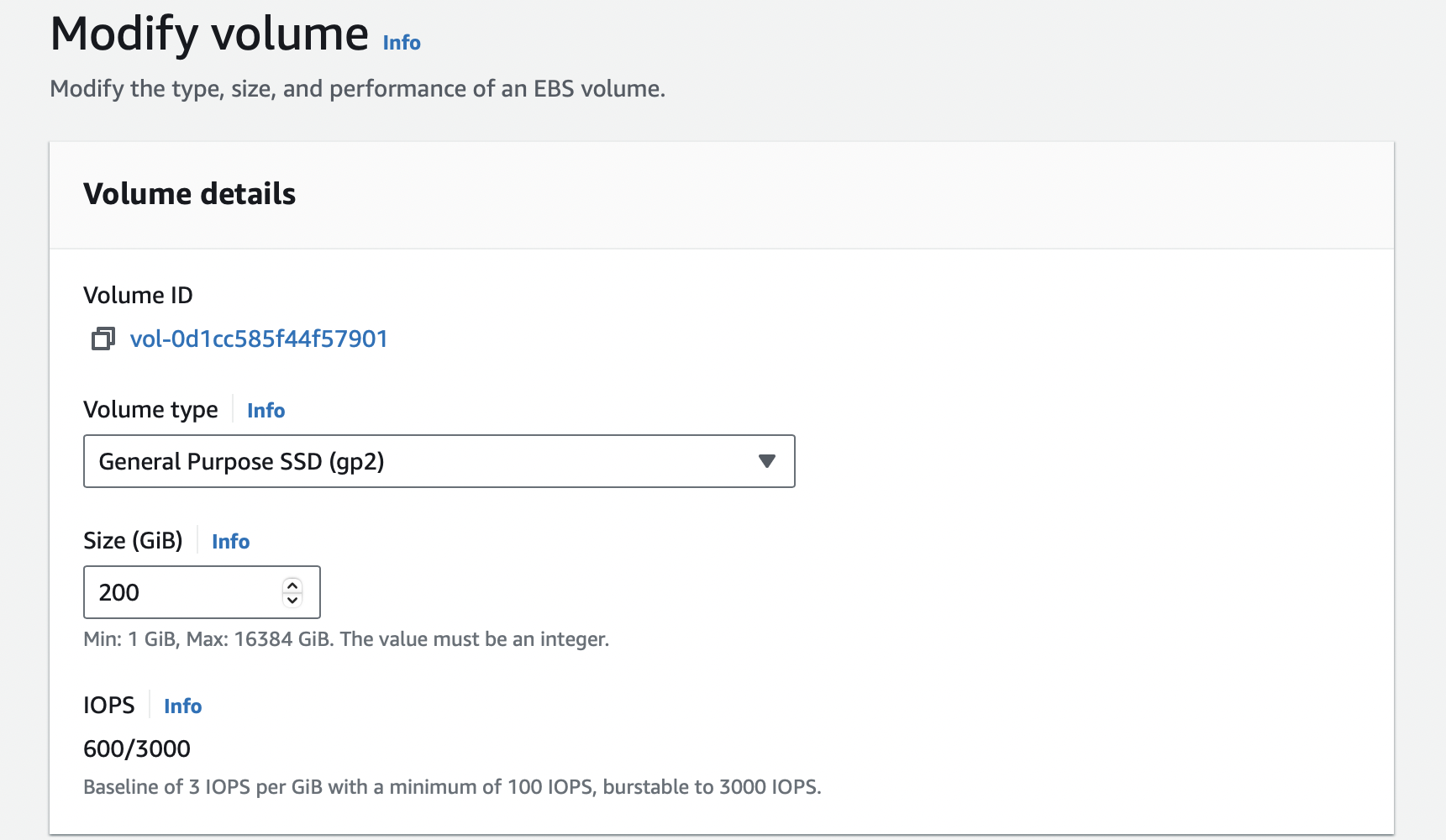

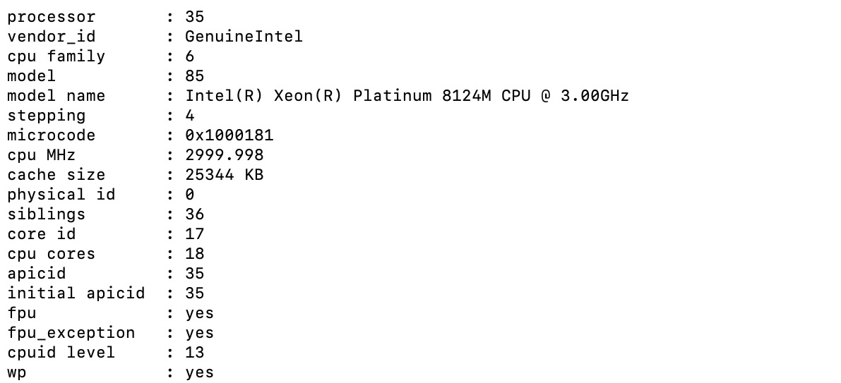

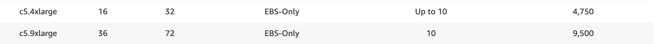

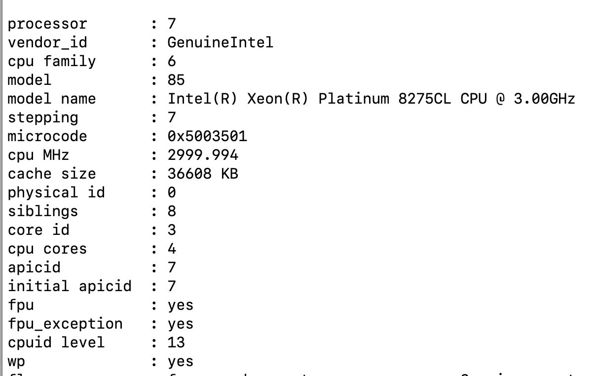

The Kubernetes platform ran on an Amazon EC2 instance with the DX images installed and configured. In AWS/Native Kubernetes, the tests were executed in EC2 instances with one c5.xlarge master node instance. The test started with a c5.2xlarge node and moved to a c5.4xlarge node. After analyzing test results and further observations, the test moved and settled with a c5.9xlarge node. Refer to the following node setup details:
c5.9xlarge node
Node details
Processor details
Volume details
