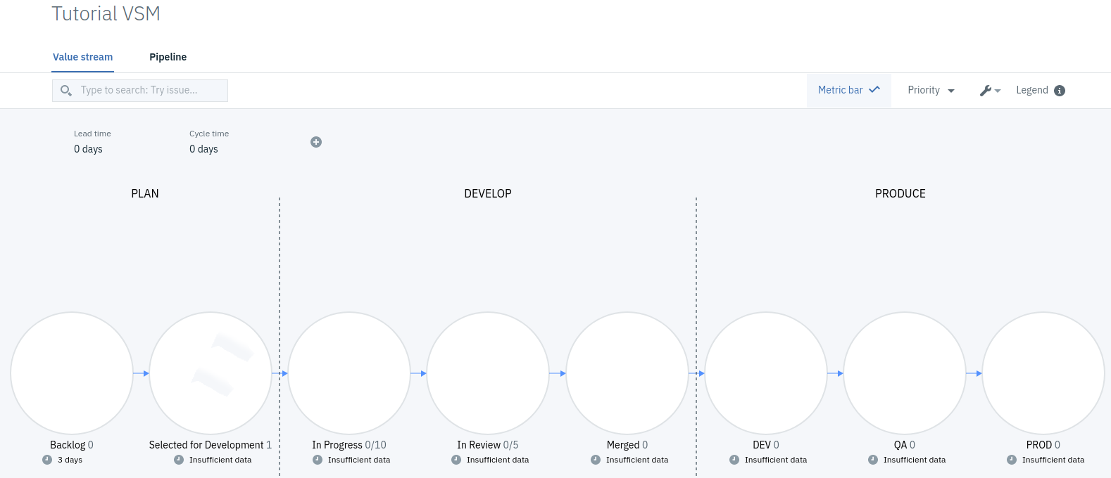

In this lesson, you created an instance of the default value stream. The highest level of a value stream is a phase. Phases represent important organizational parts of the value stream. Phases contain stages that define process flow within a phase. Stages are containers for dots. Dots represent units of work from HCL™ Accelerate or tools integrated into the value stream. In general, processing is done in left-right order.
The following figure shows the default value stream workflow. Notice anything? The stages of the Planning and Development phases correspond to the statuses in the simplified Jira workflow. Jira-related dots can move through the value stream stages as they transition along the Jira workflow. You customize value streams to reflect the tools that you use in your development lifecycle.
Figure 1. Tutorial value stream
Default value stream
At this point, the value that you created is just a framework for more important work. In later lessons, you learn how to integrate external tools into the value stream and fashion DQL queries that will populate the stages with meaningful data.
