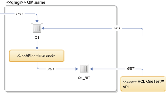

In Mirror Queues mode, HCL DevOps Test Integrations and APIs (Test Integrations and APIs) uses an WebSphere® MQ API exit, which is installed on the queue manager, to take a copy of each message and put it into another queue. Therefore, if you record multiple queues, multiple mirror queues are set up.

- Start recording on Q1.
- Test Integrations and APIs (Recording Studio) configures the API exit to mirror all messages that are put onto Q1 to Q1_RIT.
- The client puts message onto Q1 with the reply queue specified as Q1R.
- The queue manager triggers the API exit, which puts a copy of the message onto Q1_RIT.
- Test Integrations and APIs (Recording Studio) subscribes to this queue and gets the message. Test Integrations and APIs detects that message specified a reply of Q1R. Test Integrations and APIs configures the API exit to mirror all messages from Q1R to Q1R_RIT.
- The server picks up the message from Q1 and replies to Q1R.
- The queue manager triggers the API exit, which puts a copy of the message onto Q1R_RIT.
