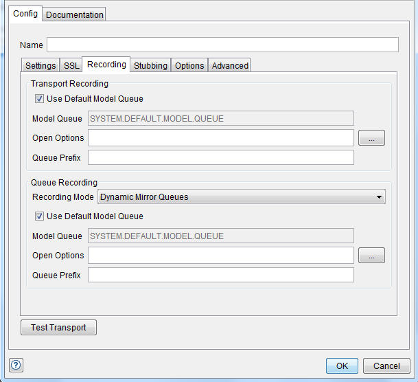

The recording method and options used when you are capturing messages in the Recording Studio perspective can be set under the Recording tab on the physical transport.
The Recording page of the MQ transport.
The following options are available on this page:
Table 2. Transport recording options
Field Description
Use Default Model Queue Specifies SYSTEM.DEFAULT.MODEL.QUEUE as the object from which to copy attributes. This option is selected by default.
Model Queue To specify a model queue other than the default, clear the Use Default Model Queue check box and enter a queue name in this field.
Open Options
You can override default options when opening model queues. By default, the field is blank, which causes the value of 1 (MQOO_INPUT_AS_Q_DEF) to be used. To specify a different open option:
  1. Click to select one, or more, open options that are supported for the operation.
  2. Click OK. The selected open options are converted into a decimal value, which is displayed in the field.
Warning:
The value entered in the Open Options field is not validated when you click Test Transport or OK. However, an invalid value causes a warning message to be displayed when you start recording.
Queue Prefix Provides a custom prefix for temporary dynamic queue names. By default, the Queue Prefix field is blank and the prefix "AMQ." is used. If you enter a value in the field, it is prefixed by "AMQ." and suffixed by "." For example, if you enter "RIT" in the Queue Prefix field, the names of any temporary queues created will have the format "AMQ.RIT.*" where "*" represents a 16-character string.

Recording Mode Select one of the following modes. Refer to Choosing a recording method earlier in this topic for more information.
Queue Browsing
No further information is required.
Proxy Queues
Provide a value for the Queue Suffix field.
Mirror Queues
Provide a value for the Queue Suffix field. This option is available only if WebSphere® MQ 7.1 and later is installed and configured in Library Manager.
Dynamic Mirror Queues
The same values are required as shown in the previous table, Transport recording options. This option is available only if WebSphere® MQ 7.1 and later is installed and configured in Library Manager.
Queue Aliasing
