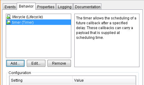

- Click the Behavior tab and then
click Add to open the Add Behavioral Entity
dialog box.
You can see the behavior-types that are provided with HCL OneTest™ API. You can also see a description of the Lifecycle behavior.
Tip: To see the Timer behavior description, select it from the list. For more information about the behavior types, see The Behavior tab.Now, you want a Lifecycle behavior instance so you can schedule a timer event to trigger after 30 seconds. You also want a Timer behavior instance so you can define a message to be sent when the timer event runs.

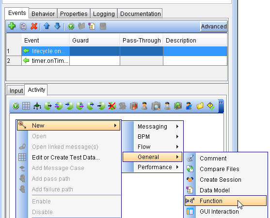

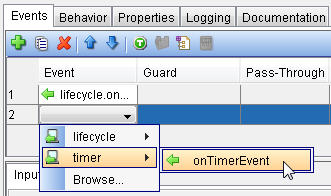

- To start a timer, you must add code to the lifecycle.onStart event.
- To add an action to run when the timer is triggered, you
can add business logic or a send message to the

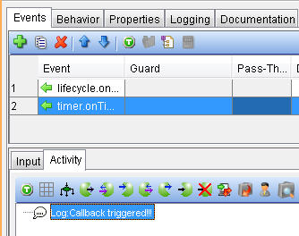

timer.onTimerEventevent.- Go to the Activity tab of this event and add a log action by right-clicking in the Activity pane and selecting .
- Type an output message and click OK to close the Log action.

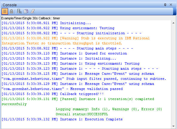

- Go to the Test Lab perspective and run the stub.
In the Test Lab, you can see that the
timerevent was triggered after 30 seconds, at which time the output messageCallback triggered!!!was sent.

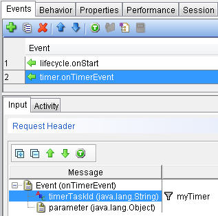

Tip: You can use filtering to act on a stub only when a specific timer is triggered. In this example, the timer event is only triggered for the timer namedmyTimer. You can also tag the parameter object and reuse it in further actions.
