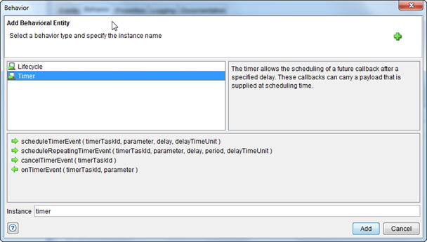

| Add | Opens the Add Behavioral Entity dialog box. The upper left side of
the Add Behavioral Entity dialog box displays the available behavior-types.
The upper right side of the Add Behavioral Entity dialog box displays
a description for each selected behavior-type.The
default available behavior-types are as follows:
The lower half of the Add Behavioral Entity dialog box displays the available sample behaviors for the currently selected behavior type. The Instance field is used to refer to the behavioral entity in function actions. This field is optional so that you can create multiple instances of a behavior. Based on the selected behavior, a default instance name is displayed. If required, you can specify a different instance name. The following sample
behaviors are listed:

Tip: To select multiple behaviors for a behavioral
entity, hold the Ctrl key and click each behavior
after you select a behavior-type on the upper left side of the Add
Behavioral Entity dialog box. After you specify the properties of a behavior, click Add to create the behavior and to close the Add Behavioral Entity dialog box. Tip: Although behavioral entities
