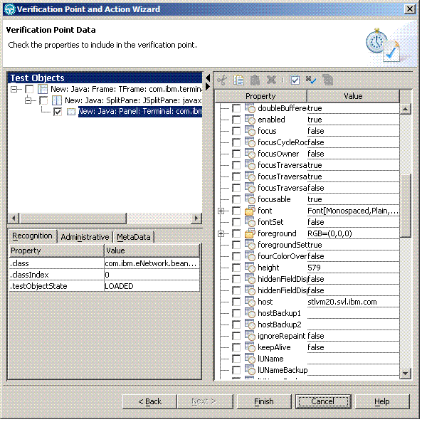

  6. Select All field properties from the list if you are checking host field attributes. Provide a verification point name, and click Next.
    The Verification Point Data page lists all the host fields from the current host screen.
    Verification Point Action Wizard window Verification Point Data page
    The fields are named Field_row_col_text, where row is the starting row of the field, col is the starting column of the field and text is the text found in the field.
  7. Optional: Clear the check box of the field for which you do not want to perform a host-attributes check. By default all host field attributes (except the host field names) are selected by this verification point. If you do not want to test all host field attributes, double-click the item in the list, and clear the attributes in the Test Data Element list.
