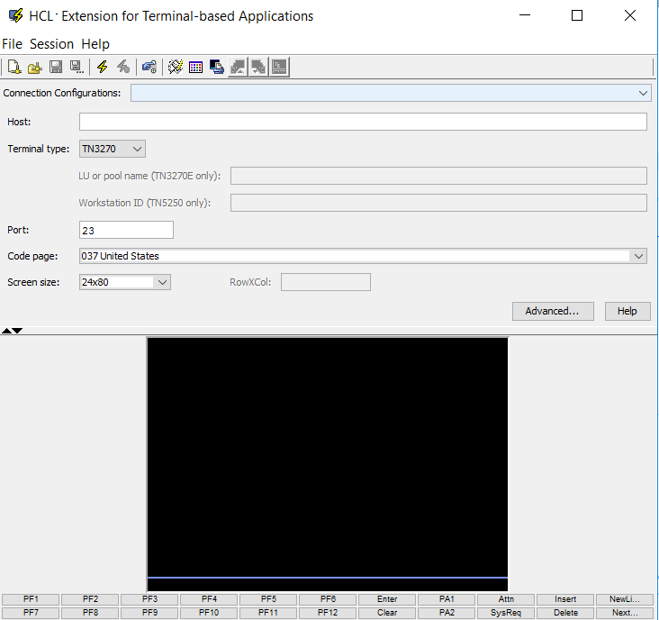

Extension for Terminal-based Applications window
Use the Extension for Terminal-based Applications window to connect to the host and record or play back host interactions in the scripts.
terminal tester hcl
The top pane of the window shows the connection configuration information. The bottom pane is the actual terminal view. You can move the divider up or down to increase the space of either portion of the window. The terminal session function keys that correspond to the function keys on the keyboard are located at the bottom of the window.
Extension for Terminal-based Applications toolbar uses the icons shown in the Table 1:
