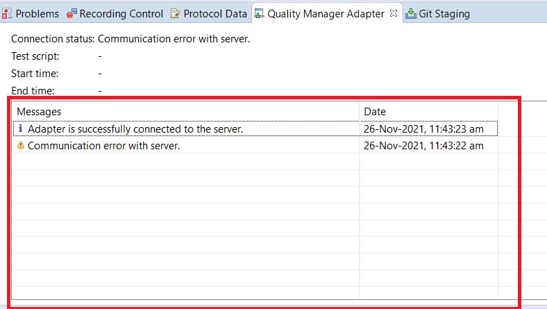

In the GUI mode, when a script is run from Engineering Test Management, you can see the test run in progress inside Test UI as though the test were run manually in Test UI.
Push buttons to connect and disconnect to the Engineering Test Management server are located in the upper-right corner of Quality Manager Adapter view. This view also has a local preferences menu that you can use to control some behavior of the GUI mode adapter. If you see errors or warnings, use the Error Log view for further investigation.
You must not use Test UI while the adapter is running. If you do so, you might interfere with the ability of the adapter to run test scripts. You must stop the adapter before you open Test UI.
The following image displays the activities of the adapter in the Quality Manager Adapter view:
etm_adapter_activity
