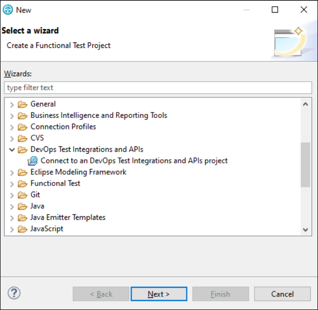

  • In Test UI, right-click on the Test Navigator, select New > Other > DevOps Test Integrations and APIs > Connect to a DevOps Test Integrations and APIs Project and click Next.
    Connect to Test Integrations and APIs project wizard page
  • In the wizard page, click Browse and select the root folder that contains the project.
    If the path contains a project, its name should automatically appear in Project Name and the Finish button should be enabled.

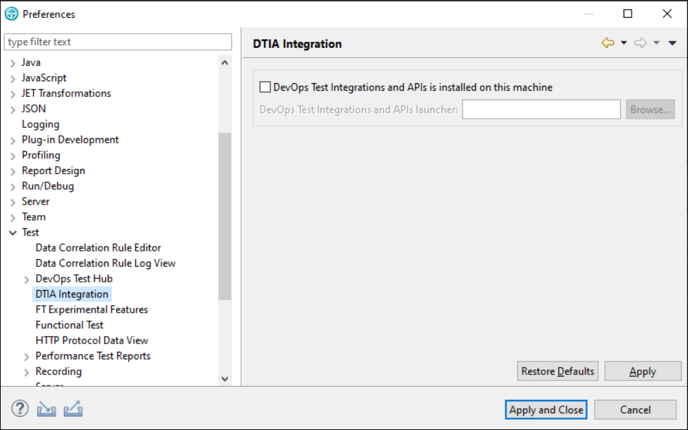

Setting Test Integrations and APIs preferences
To be able to open a Test Integrations and APIs project from Test UI Test Navigator, you need to have both the products installed on the same computer, and you must set the path to the execution file in the Preferences.
  • In Test UI, click Window > Preferences > Test > DTIA Integration.
  • Click Browse and set the installation path to Test Integrations and APIs execution file. On Windows, the default location can be C:\Program Files\HCL\DevOpsTestAPI\IntegrationTester.exe.
  • Click Apply and OK.
    Use the browse button to select Integration Tester execution file

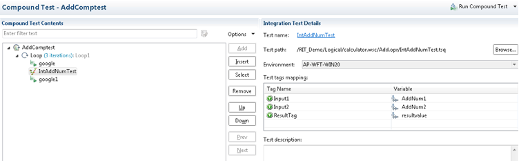

Modifying Test Integrations and APIs environments in UI Test perspective
In the compound test, you can select Test Integrations and APIs tests and change the environment of each test. The environments are set in Test Integrations and APIs, you can only change the selection from the edited compound test.
  • Open the compound editor and select a test.
  • In the Test Integrations and APIs details, you can browse and change the properties of the selected test. The Test path, the Environments and Description are automatically updated accordingly.
    adding component
  • To select another environment for the Integration Tester test, use the dropdown menu.

To map the tags in Test Integrations and APIs with variables in Test UI, you must follow these steps:
  1. Click the Test Integrations and APIs test that contains the tags that you want to map.
    The Test Integrations and APIs tags are displayed in the Integration Test Details pane.
  2. Click the tag that you want to map with the variable in Test UI.
  3. Click the Ellipses button inline with the tag that you want to map with a variable.
    The Variable Selection dialog is displayed.
  4. Select the variable, and then click OK.
    The tag is mapped to the selected variable and it is displayed in the Variable column.
While you map a tag in Test Integrations and APIs test to a variable in Test UI, you can map only tags that contain the string value to variables. You cannot map a tag that contains multiple values to a variable in Test UI.
