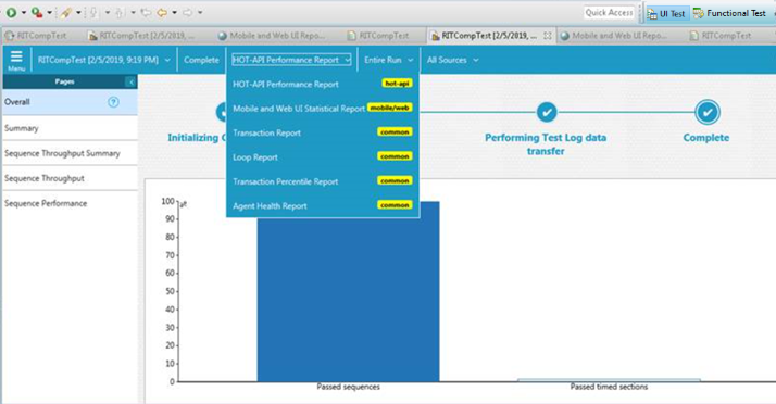

After the run completes, the Test Integrations and APIs report displays statistics on the executed sequences and Timed Sections if some are defined in the tests.
Overall page of the report
