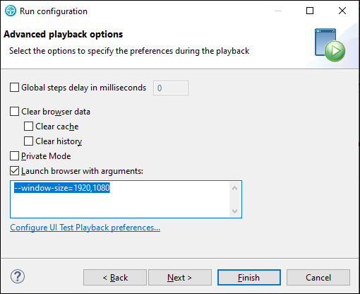

You must perform the following steps on the Run Configuration dialog while you play back the test in Google Chrome:
  1. Select the options as required for the test run on the Run Configuration page.
  2. Click Next.
    The Advanced playback options page is displayed.
  3. Select the Launch browser with arguments checkbox to specify the argument.
  4. Enter the following browser argument in the text box:
    --window-size=x,y
    Test UI opens the browser with the specified argument and its value. For example, use the following value:
    browser arguments
  5. Click Finish.
