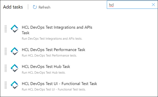

Add a task to the agent job by completing the following
steps:
