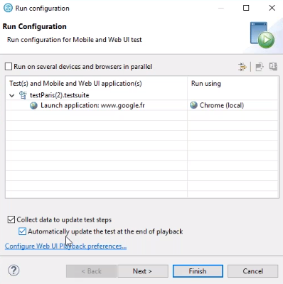

  1. Open your test in the Test editor, and click Run.
  2. To enable guided healing feature, select Collect data to update test steps in the Run configuration dialog box.
  3. To enable automatic updating of the test, click Automatically update the test after the end of the execution and click Finish.Guided Healing and automatic update options are selected
The test is updated and can be run with no failures.
