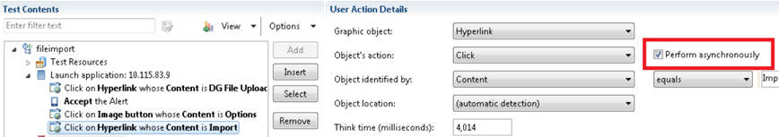

- By selecting Perform asynchronously while selecting click, hover or Press Enter actions.

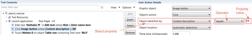

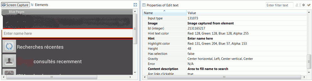

OBJECT PROPERTIES
Object properties are captured during test recording and displayed in read-only mode in the Properties table of the UI Test Data view. To find an object in the application-under-test during playback, HCL OneTest™ UI compares the properties of the object that are captured during the recording with the description of the properties that are displayed in the User Action Details area of the test editor. These properties are different for Android, iOS, or Web UI applications.
When you select a step in a recorded test, the test editor displays the object properties on which an action is performed. The object properties are listed in the Object identified by field, followed by the operator field and an insert field for the property value. Among the standard object identifiers, you can find Content, Class, Id, 'Xpath depending on the graphic object.
You can change these parameters (property, operator, property value) in the User Action Details area of the test editor or from the UI Test Data view by using the context menu. When actions are selected in the Test Contents list, the UI Test Data view is automatically synchronized to display the screen capture for the step selected. Properties can be modified in the Screen Capture tab, in the Elements tab, or in the Properties table by using the context menu.
To improve the object identification, specify the properties to be used in the test. Some applications are using properties that are described by custom attributes, and they are not automatically detected at the test run. To overcome this standard behavior, you can set an ordered list of the custom attributes so that they are identified as the main properties and used during the test execution.

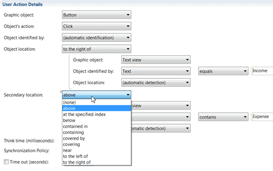

OBJECT LOCATION IN A TEST
When a test is run, the graphical objects in the test must be detected automatically, but in some cases, the element on which the action is performed might be difficult to identify. In this case, you must update the test script and give more accurate information to locate the object on which you want to perform the action.
Here is an example: You record a test, and one step is 'Click on Edit text whose content is 'August 30th, 2013'. If the test is played back automatically, it will fail if the date is no longer August 30, 2013. You must modify the step and give more accurate information to locate the object on which you want to perform the action. That way, the object can be found and used automatically when the test is run. HCL OneTest™ UI offers various ways to identify and locate objects and increase test script reliability.
In HCL OneTest™ UI, various object location operators are available to identify objects in an application-under-test. They are displayed in the Object location fields in the User Action Details area of the test editor. Two object locations can be used in a test step to set location conditions and find the target object in the test. For details, see Setting object location conditions in a test script.
