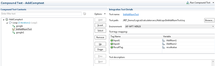

Modifying HCL OneTest™ API environments in UI Test perspective
In the compound test, you can select HCL OneTest™ API tests and change the environment of each test. The environments are set in HCL OneTest™ API, you can only change the selection from the edited compound test.
  • Open the compound editor and select a test.
  • In the HCL OneTest™ API details, you can browse and change the properties of the selected test. The Test path, the Environments and Description are automatically updated accordingly. adding component
  • To select another environment for the Integration Tester test, use the dropdown menu.
Alternatively, you can change the environment selection for a test for a collection of tests:
  • Right-click on the tree at any level under a node in the compound test and select Replace HCL OneTest™ API Environments.
  • In the Set Invocation Tester Environments wizard, the first page displays the list of projects that use the selected environment and the number of tests from project that use this environment in the compound test. Different environments of a project
  • Select another used environment in the dropdown list. Click Finish. The new choice applies to the selected node and its children.
