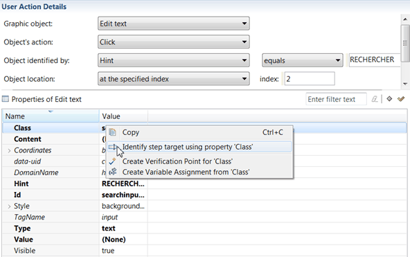

Drag the property to the Object Identified by field
in the test editor. Or, right-click the property in the table and
select Copy, then Paste in
the Object Identified by field. Another method
is to right click a property in the table, and select Identify
step target using property.

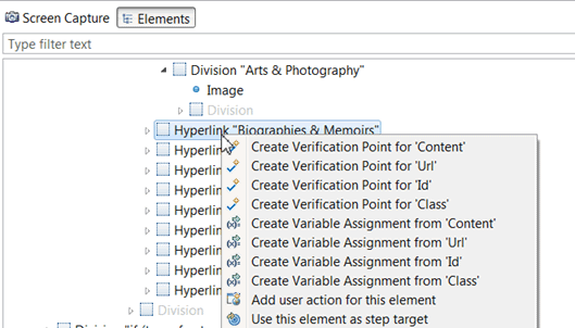

A menu item is available for each candidate property in the context menu of the Screen Capture view (see Figure 2). If the newly selected property is inappropriate, a message warns you that object recognition may be broken. The property name and its value are replaced in the Object identified by fields.

Figure 1. Modifying the object property and value from the Properties context menu
Figure 2. Modifying the property and value of an object captured during the test recording with a candidate property from the Screen Capture context menu
