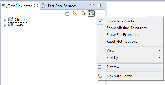

Results .xmoebreport, .stats, .rstats, .pstats, and .mstats These are results assets and contain the data that is used to create reports and should be under source control. Some of these assets are not visible in the Test Navigator. To see these assets, in the Test Navigator view, click the drop-down icon and select Filters and clear the Statistics Stores check box. Test Navigator Filter
You can perform the check out and check in operations from this view. Store the results in a separate results folder, which you can specify when running a schedule or test.
