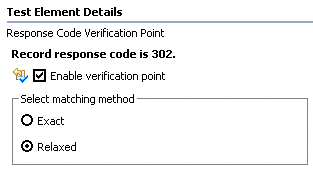

  3. Click the verification point to display the response code editing fields in the Test Element Details area.
  4. To disable an individual response code verification point, clear the Enable verification point field.
  5. From the Select matching method list, click an option to indicate how closely the returned response code must match the recorded value.
    OptionDescription
    Relaxed If the recorded response code is 200, 201, 202, 204, 206, 301, 302, or 304, then a returned response code of any of those values causes the verification point to pass. If the recorded response code is any other value, it is the same as if you had specified an exact match.
    Exact An error is reported if the returned response code does not match the recorded value.
