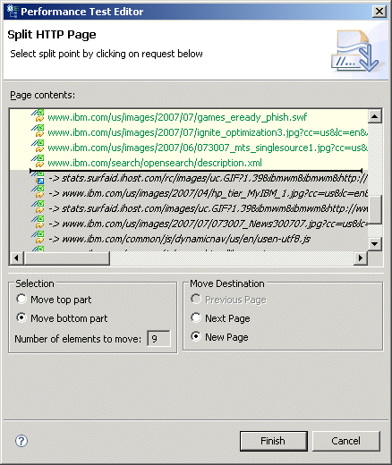

  3. Right-click on the request where you want the split to occur, and select Split page here.
  4. In the Split HTTP Page window, you can change the location of the split by clicking on another page element.
    You can also create a new page, combine the elements above the insertion point with the previous page, or combine the elements below the insertion point with the next page.
    Split HTTP page window, where you can select the location of the split.t
  5. To split the page, click Finish.
