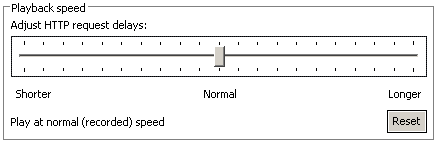

To scale the delays:
  1. In the Test Navigator, browse to the test and double-click it.
    The test opens.
  2. Click the name of the test.
  3. In the Test Element Details area, select a scaling percentage. Move the slider to scale the speed at which the HTTP requests are sent. You can specify a range from no delays to twice the recorded length.
    This scale is applied to all requests in the test.
    If you increase playback speed dramatically, requests might occur out of order. To correct this problem, decrease playback speed until the test runs correctly.
    playback slider in Test Element Details section
