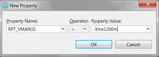

  4. In the New Property window:
    1. In the Property Name field, type RPT_VMARGS.
    2. In the Operator field, confirm that the operator is =.
    3. In the Property Value field, type -Xmxnnnnm, where nnnn is the amount of memory, in megabytes, and then click OK.
    If you need to set multiple RPT_VMARGS values for a location, place them in the same property entry and separate them with a space. Do not use multiple property entries to set multiple RPT_VMARGS values for a location.
    The following New Property window sets maximum heap to 1200 megabytes:
    New Property window, which shows the Property Name set to RPT_VMARGS, the Operator set to Equals, and the Property Value set to -Xmx1500m
