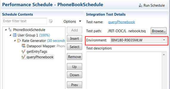

You can select Test Integrations and APIs tests and change the environment of each test in the schedule or compound test,The environments are set in Test Integrations and APIs, you can only change the selection from the edited schedule or compound test.
  1. Open the schedule or compound editor and select a test.
  2. Browse and change the properties of the selected test in the Test Integrations and APIs details, The Test path, the Environment and Description are automatically updated.
    Select another environment for the test in the list
