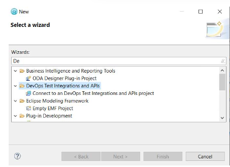

  1. Right-click the Test Navigatorin Test Performance.
  2. Select New > Other > DevOps Test Integrations and APIs > Connect to an DevOps Test Integrations and APIs Project and then click Next.
    connect to devops integration test
  3. Click BrowseIn the wizard page, and then select the root folder that contains the project.
    If the path contains a project, its name should automatically appear in Project Name and the Finish button should be enabled.
