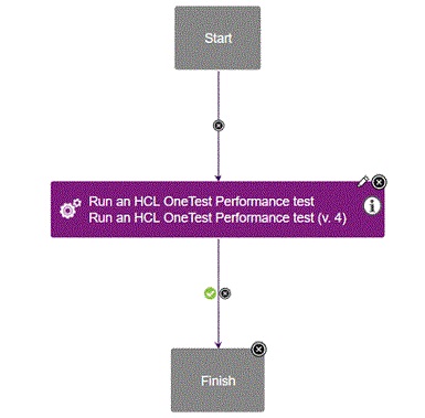

A typical process for the performance test plugin will look like the following snapshot:Run performance test from UCD

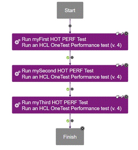

A process with multiple tests will look like the following snapshot:Run multiple tests from UCD

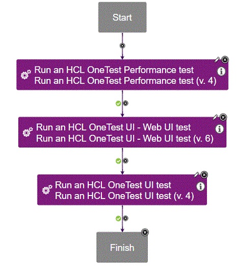

If you have multiple products installed on one target machine, either in the same or different package groups, you can use a single process that includes steps from different products. The process will look like the following snapshot:Run multiple products test from UCD
