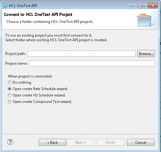

  • In HCL OneTest™ Performance, right-click on the Test Navigator, select New > Other > HCL OneTest API > Connect to an HCL OneTest API Project and click Next.
    Connect to HCL OneTest API project wizard page
  • In the wizard page, click Browse and select the root folder that contains the project.
    If the path contains a project, its name should automatically appear in Project Name and the Finish button should be enabled.
  • In When project is connected, you have to perform one of the following actions:
    • Click Do nothing to only import the project.
    • Click Open Create Rate Schedule wizard to select the test, create a Rate Schedule, and add the test to it.
    • Click Open Create VU Schedule wizard to select the test, create a VU Schedule, and add the test to it.
    • Click Open Create Compound Test Wizard to select the test, create a Compound test, and add the test to the Compound test. For more details, see Creating a compound test and Adding tests into a compound test.

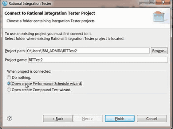

      For example: select the Open Create VU Schedule wizard action and click Next. Connect to Integration Tester Project wizardConnect to API tester project wizard
      The Create Rate Schedule for Integration Tester or Create VU Schedule for HCL OneTest API wizard displays the list of tests contained in your project.
    • Select one or more tests and click Next.
    • In Schedule File Name and Location wizard, select a schedule in an existing project, or create it from this window. You just need to enter a name for the new schedule and click Finish. The procedure is the same for the compound test.

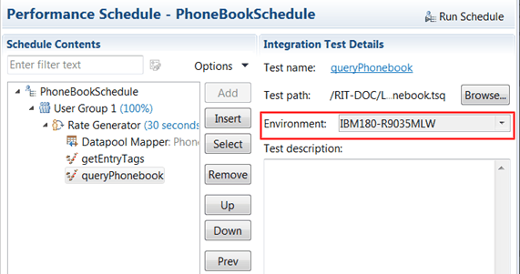

Modifying HCL OneTest™ API environments in HCL OneTest™ Performance
In the schedule or compound test, you can select HCL OneTest™ API tests and change the environment of each test. The environments are set in HCL OneTest™ API, you can only change the selection from the edited schedule or compound test.
  • Open the schedule or compound editor and select a test.
  • In the HCL OneTest™ API details, you can browse and change the properties of the selected test. The Test path, the Environments and Decription are automatically updated accordingly. Select another environment for the test in the list
  • To select another environment for the Integration Tester test, use the dropdown menu.
Alternatively, you can change the environment selection for a test for a collection of tests:
  • Right-click on the tree at any level under a node in the schedule or compound test and select Replace HCL OneTest API Environments.
  • In the Set Invocation Tester Environments wizard, the first page displays the list of projects that use the selected environment and the number of tests from project that use this environment in the schedule or compound test. Different environments of a project
  • Select another used environment in the dropdown list. Click Finish. The new choice applies to the selected node and its children.
