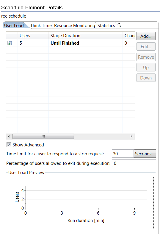

By default, the User Load option contains one stage with five users that run until finished. The following figure shows the default User Load option.

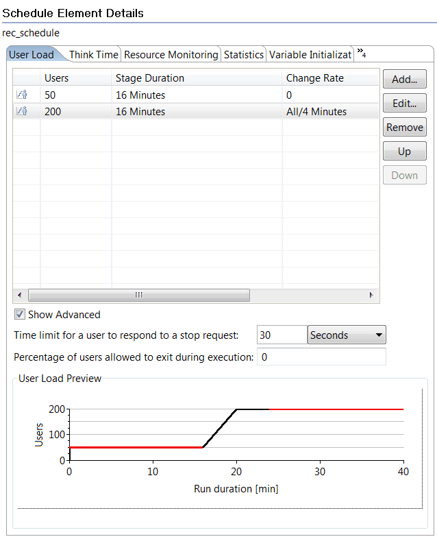

Examine the User Load Preview section
to verify that the stages are set correctly. The red line segments
indicate that the total number of users has been achieved for the
stage and the settle time, if one is specified, has ended.
The following figure illustrates a VU Schedule with two 16-minute stages. The second stage has a 4-minute change rate and a 4-minute settle time:
