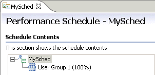

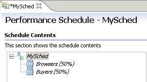

When you add items to a schedule, they appear in italic type, as shown below. The italic
type changes to regular type after you save the schedule.

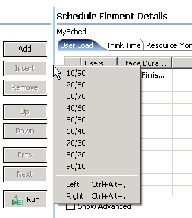

- Click Ctrl+Alt+> or Ctrl+Alt+< to enlarge or reduce the window.
- Hover at the left side of the Schedule Element Details area. When you
see a vertical blue line, right click the line and select a size ratio from
the menu.
