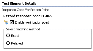

Note: When you modify a test, the modified items appear in italic type. The italic type changes to regular type after you save the test. - Click the verification point to display the response code
editing fields in the Test Element Details area.
- To disable an individual response code verification point, clear the Enable verification point field.
- From the Select matching method list,
click an option to indicate how closely the returned response code
must match the recorded value.
Option Description Relaxed If the recorded response code is 200, 201, 202, 204, 206, 301, 302, or 304, then a returned response code of any of those values causes the verification point to pass. If the recorded response code is any other value, it is the same as if you had specified an exact match. Exact An error is reported if the returned response code does not match the recorded value.
