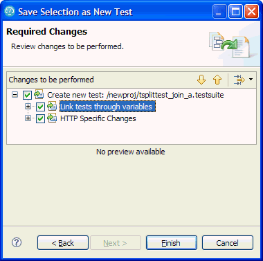

Selecting Mark the selection in the editor makes it easier to split a test into multiple parts. The marks in the editor are removed when you close the test. You cannot save marked test elements. Right-click and select Clear Range to remove the marks if you want to save the selected test elements again. - Optional: On the next page of the Save
Selection as New Test wizard, examine the changes to be
performed as a result of the split.Typically, you leave Link tests through variables and HTTP Specific Changes selected; clearing these options might make a split test unusable or produce unpredictable results. However, you can clear specific Link tests through variables boxes if you do not want certain data to be correlated between the tests.
- Click Finish.
The new test is created from the selected elements. The test variables that are created by splitting a test are listed in the Variables Created by Split Test container in the new test. For best results, open the Variables Created by Split Test container in the new test and make sure that the variables are created and assigned with values by a test that is executed before the newly split test. For more information on test variables, see About test variables and Declaring and assigning test variables.
