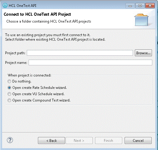

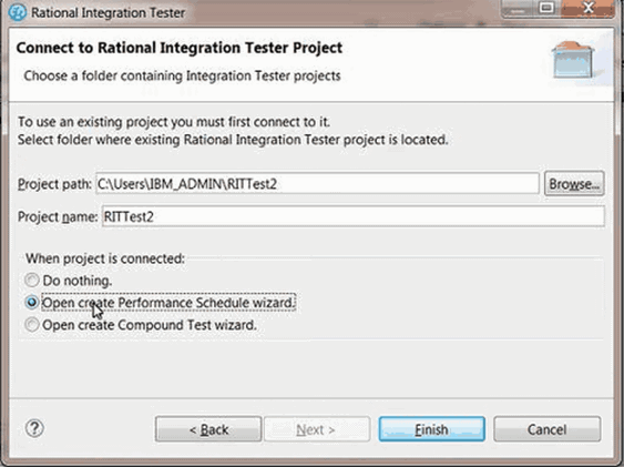

  • In HCL OneTest™ Performance, right-click on the Test Navigator, select New > Other > > Connect to an HCL OneTest™ API Project and click Next.
    Connect to HCL OneTest API project wizard page
  • In the wizard page, click Browse and select the root folder that contains the project.
    If the path contains a project, its name should automatically appear in Project Name and the Finish button should be enabled.
  • In When project is connected, you have to perform one of the following actions:
    • Click Do nothing to only import the project.
    • Click Open Create Rate Schedule wizard to select the test, create a Rate Schedule, and add the test to it.
    • Click Open Create VU Schedule wizard to select the test, create a VU Schedule, and add the test to it.
    • Click Open Create Compound Test Wizard to select the test, create a Compound test, and add the test to the Compound test. For more details, see Creating a compound test and Adding tests into a compound test.
      For example: select the Open Create VU Schedule wizard action and click Next. Connect to Integration Tester Project wizardConnect to API tester project wizard

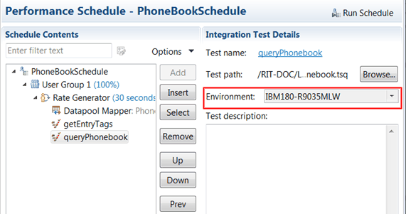

In the schedule or compound test, you can select HCL OneTest™ API tests and change the environment of each test. The environments are set in HCL OneTest™ API, you can only change the selection from the edited schedule or compound test.
  • Open the schedule or compound editor and select a test.
  • In the HCL OneTest™ API details, you can browse and change the properties of the selected test. The Test path, the Environments and Decription are automatically updated accordingly. Select another environment for the test in the list
  • To select another environment for the Integration Tester test, use the dropdown menu.
