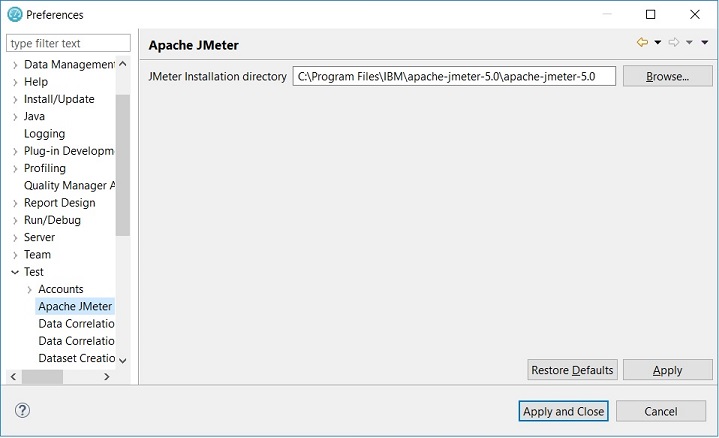

- To access the preference settings for Apache JMeter, click and point it to the apache-jmeter-5.0 directory.

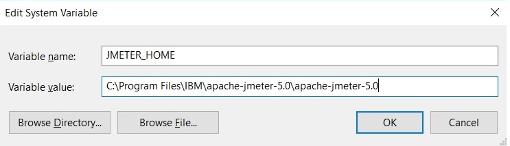

- Set the environment variable JMETER_HOME and point it to the
